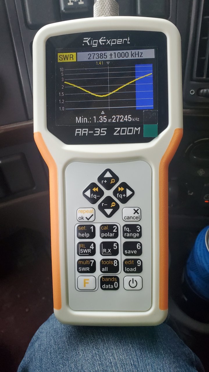

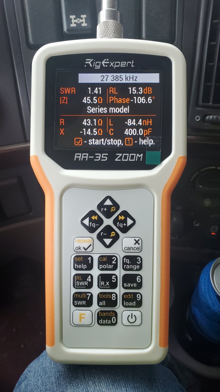

    Bazed on your pic....The resistence # is a tad low but no biggie if not dead on at 50 ohms...The resonance is off a good bit so work that bugger up to a zero..Watch that return loss get higher (higher is better,sounds wrong but its not)and swr drop a bit..
    Those #'s can change with how clean the connection of mount to truck,coax connection(how well coax is attached to the pl259)coax and pl259 itself,where ant is mounted,angle of ant on mount,ant stud....That analyzer opens up a whole new world..
    ENJOY!!
