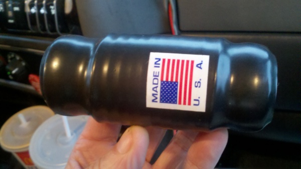

    I got the solution for you. You're going to need a machine shop to make one of these for you but once you have it you can screw a 9-foot whip directly into the top of it and cut that whip to any length you desire and whined yourself a copper coil around this thing to tune the antenna for any length you desire.
    Then you'll be able to smash that whip into anything you want without having to worry about damaging something.
    the more top-heavy and fragile the antenna is, the better it will perform and as you move the load to the bottom of the antenna you will notice a drastic reduction in how it performs although it will be indestructible at that point.
