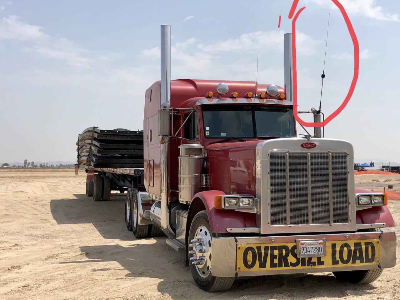

    Which antenna are you using? If you use a narrow banded antenna it will eliminate much of that noise and make it easier to hear stuff

    4.5 foot Francis.

    Im going to put the stock antennas back on ( top loaded fiberglass) they are probably about as narrow banded as an antenna can be.

    Have you ever tried those flexible Hustler antennas with the load about three-quarters of the way up towards the top?

    Yes, I have one that I used on Cascadia, need to get a second one since antenna setup is co- phased, I know Clays sell them, I will be heading down to Texas after final delivery in MT, hopefully I will make it to San Antonio, Ive been wanting to try those.

    If I were a betting man I would have to put my money on the fact that the real problem lies with the cheap coax instead of so much with the antennas.

    That Wilson 2k is over 25 years old. I upgraded the shaft to 18”. Stinger been replaced only once thru it’s lifetime.

    which antenna commonly available is considered narrow banded? there was a post some time ago about tuning an antenna, marking the whip, then adding a spring and returning. mark the whip again. the antenna with the marks closest together is more narrow banded.
    does that sound about right
