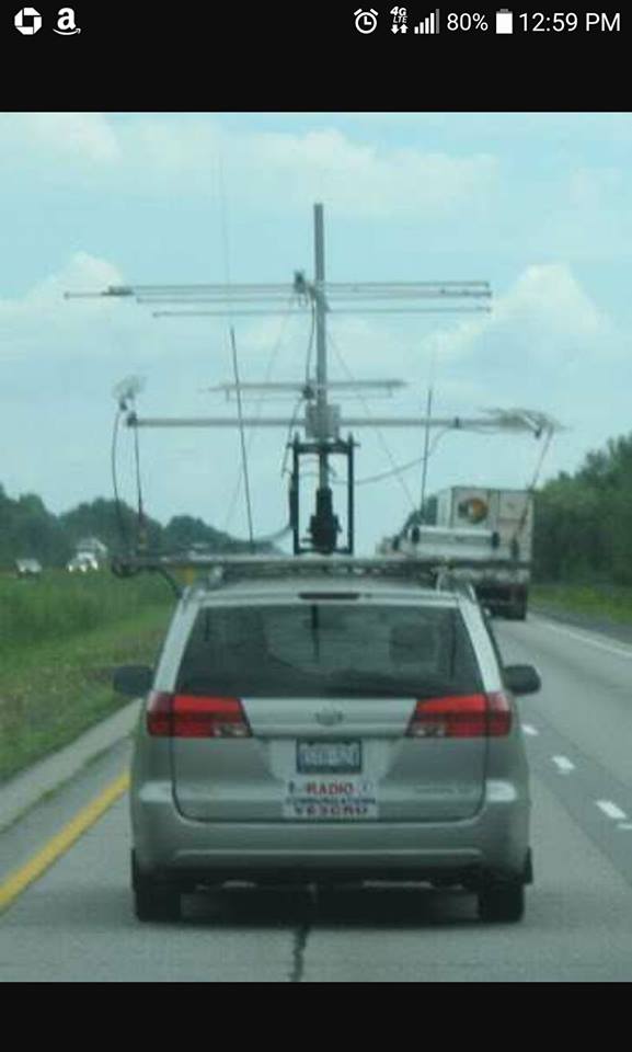

  5. mike5511
    mike5511 Road Train Member
    3,157
    1,547
    May 15, 2011
    NW Arkansas
  6. amtraktrekker
    amtraktrekker Bobtail Member
    3
    4
    Sep 5, 2012
    Looks like you could flush the toilet on the space station with that setup!
    mike5511 and wolverine11 Thank this.
  7. rabbiporkchop
    9,679
    6,548
    Feb 9, 2012
    Wapwallopen, Pa
    I kind of like this setup.
