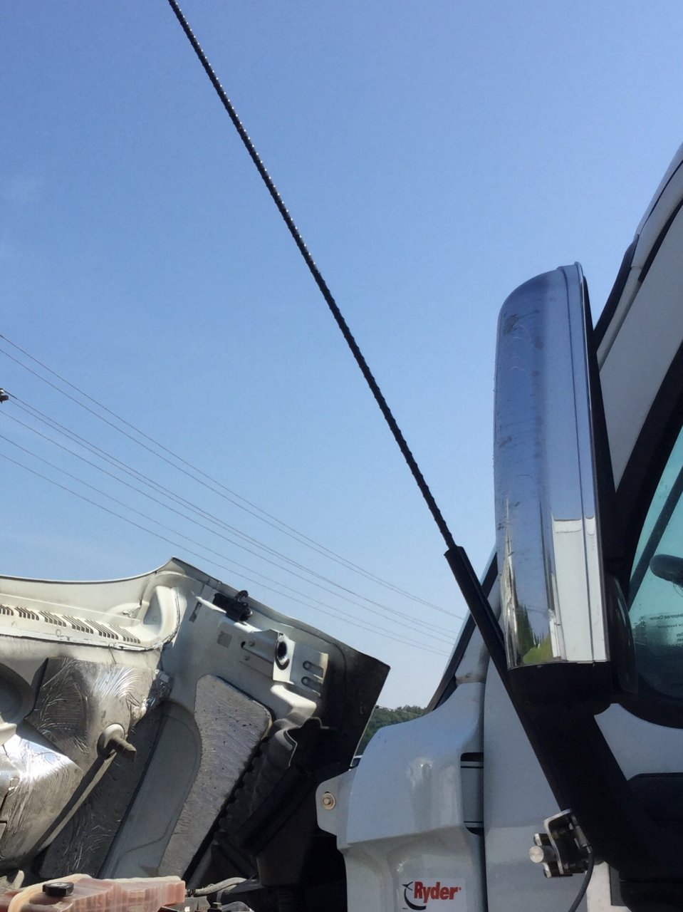

    6546DBDD-9DEA-4F2A-878B-46585AB04417.jpeg I’ve had cb’s in 8 vehicles over 22 years. Only one did I put an analyzer on to check. The rest I just use an swr meter and a Bird 43 to measure reflect. If I am at 1 percent reflect on total output, I call it a day. My current truck is a 2017 Cascadia with a 6 foot skipshooter on the door, 18 foot of coax, talks DX and local well. It shows 1% reflect so I am satisfied. Antenna flexes some, so I put a piece of pvc painted to match to keep it from going past vertical, swr’s stay in check.

    The only problem with going to the 5 foot or even the 6 footer is the stud on the mirror, I am a bit affraid that it will break due to the force going down the road.

    You may consider doing like I posted in the picture above. A piece of 3/4 inch pvc fits over the stud and absorbs most of the wind. It has some wiggle room so the stud isn't absorbing all the windload.

    I have 5's with no issue so far. You can use a bulged HD spring. Don't use the straight spring or your antenna will be pointing at your trailer going down the road.
