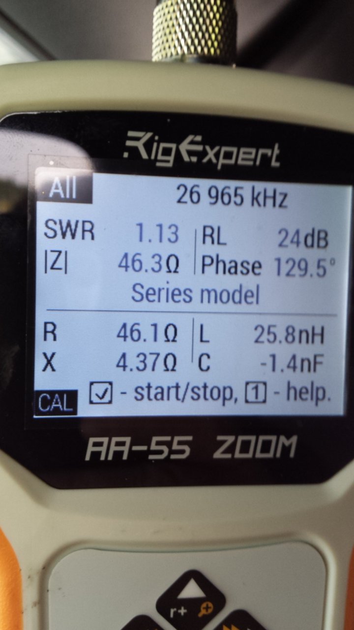

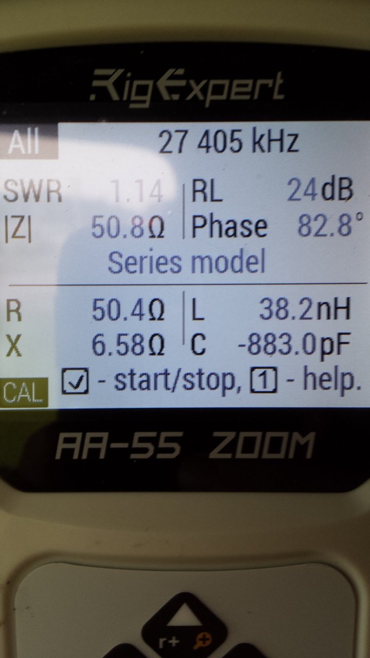

    K..Now i have a question re ant tuning..My nail on my skip shooter is bottomed out..Its actually has no whip showing(sorta speak,just no head on the nail)My resonance point still needs to be lower..I have yet to start any bonding but think it will help with resonance??
