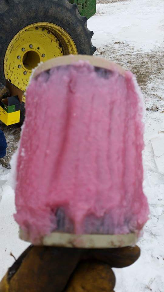

    FB_IMG_1482250003883.jpg good picture of poorly treated fuel. For my time and money anything that sits outside and I need to run when I need it we run straight #1 fuel. I've had terrible luck with using additives. Now in my Peterbilt I will run straight #2 all winter but she stays in the warm shed at night and the Kitty car returns enough fuel to keep the tanks well above freezing

    mmm. looks tasty. raspberry?

    Lol, that was my thought as well, "Man that's a nasty looking freezer pop..."

    That must be off road fuel. Looks like one heck of a problem.

    I forgot that many of you have probably never seem red diesel (off road non taxed). I think the day this tractor gelled up we probably just dropped in a new filter with lots of 911. Get them to run and walk away for a few hours the fuel will warm up.
