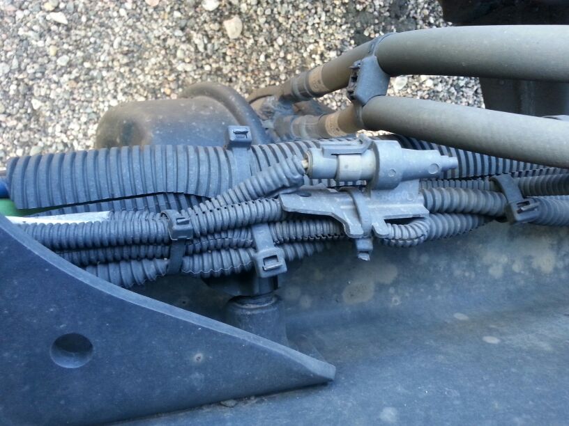

  8. X-Country
    X-Country Medium Load Member
    645
    462
    Mar 27, 2014
  9. Highway Hypnosis
    Highway Hypnosis Light Load Member
    144
    135
    Apr 12, 2014
    Minot, ND
    I believe that would probably be an ambient air temp sensor. 2-wire power & ground with changing resistance depending on the outside air temperature.
    X-Country Thanks this.
