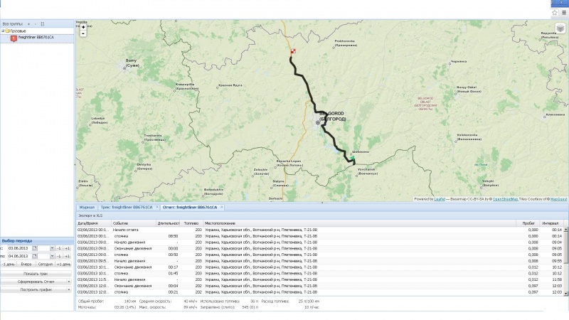

    simple car alarm helps
    + DVR around truck
    + GPS tracker
    I use GPRS/3G on line GPS tracking and I can see truck position, fuel level and data from J1708 Datalink in real time

    I use Ukrainian local servise DaGama, they make small boxes that are connected to J1708 and J1939. They use optional fuel level sensors in every tank. Full setup is about $600-700 per vehicle, and I pay about $20 per mounth. I use GoodLine GSM card becouse this SIM card works worldwide
