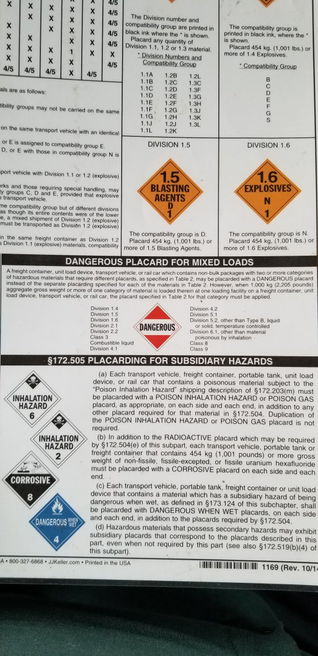

    Heres the regulation interpretation. But it has a word that is getting people in trouble in California and is up for debate. Aggregate. Some are taking that to mean when you load multiple un # with some under a 1000lbs total but you have at total gross over 2200 of hazmat you must fly dangerous.
    Thing is the only the can doing for running a dangerous placard is if you have all over 1001 lbs as an example all un1993 or a split load where its 10000lbs of this or that. But if you have 10 lbs on the truck they combined with other hazmat you satisfy the requirements.
    archangelic peon Thanks this.
  9. Antinomian
    Antinomian Road Train Member
    2,225
    3,578
    Feb 17, 2013
    Page 29.

    No it wasn't there.
