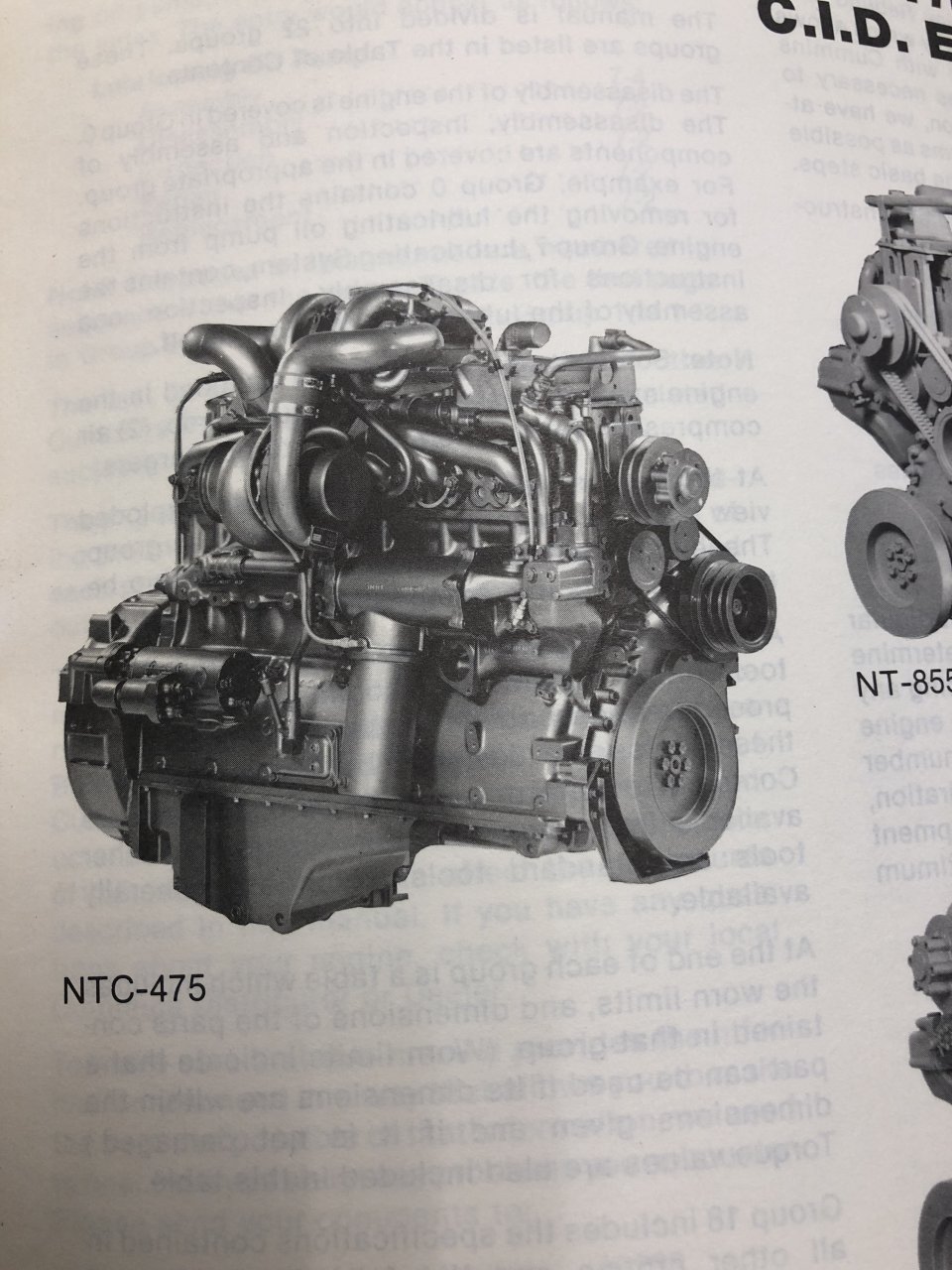

    image.jpg Looked up the 475 in shop manual. They did just have a NTC 475. Hi flo FFC cooling. Was twin turbo.

    Yes, that's my engine.

    SmallPackage: geez, they had twin turbo then? :eek:
    Should be a smoke free engine.
    Always something for me to learn. ;)

    ###### boy!!
    Those were big horses back than. They made 3406’s nervous.
