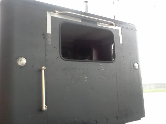

heres some pics i had to buy a newer tighter rubber seal for window to sit right as the old one was for thicker surfaces. i cut thru with a electric hand jigsaw with a metal cutting blade. cut right thru like butter and support brace to, i installed dry now silicone window is on real tight.i had to spend $40 extra on seal but it was worth it.
![[IMG]](proxy.php?image=http%3A%2F%2Fi1181.photobucket.com%2Falbums%2Fx437%2Fpeterbilt97%2FFreightshaker%2520flat%2520black%2Fwindow1.jpg&hash=965ced96ff8057dcca53cbe09f296281)
i cut interior panel by measuring from inside and using old piece of wall cutout to make perfect cut with a box cutter, i will be using a rubber moulding to fit over the edge of the cut i made. looks great and all i have left to do now is 5% tint it to not worry about the sun or having to put up a curtain. later i wil make a button type cover if anything i am very happy i figured the structual integrety of the back wall wouldnt hold and i was wrong as its was very tight still i even sat on the roof to test i wiegh in at 240lbs no flex,bend or wobble.my older freightshakers sleeper is built pretty sturdy tho i can tell you that.

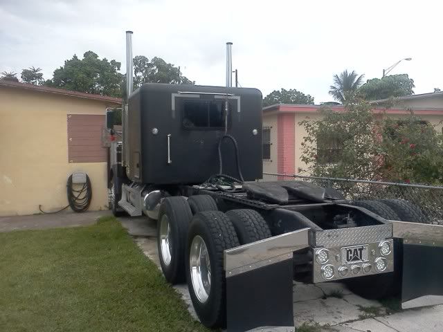

finished productGetstepn Thanks this. -
![[IMG]](proxy.php?image=http%3A%2F%2Fi1181.photobucket.com%2Falbums%2Fx437%2Fpeterbilt97%2FFreightshaker%2520flat%2520black%2Fwindow2.jpg&hash=0b7a7dd70305f9e39e0ebde9c6003216)
now i can repaint my back wall and figure a new idea for my air hoses and such my next idea is to buy a diamond plate battery box that insets into the chassis frame rails and then i want to make a deckplate catwalk out of diamond plate as well to finish the top part of the rear chassis. the i will have air hoses come out of one of those stainless coffin boxes.
