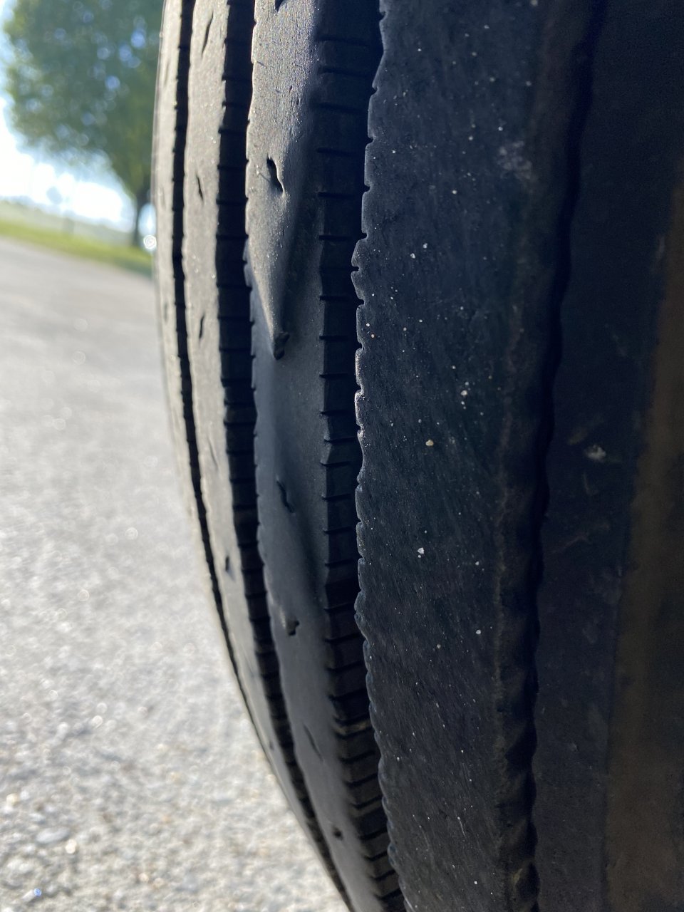

    Check king pins, check the nut on the axle. When the bearing wears the axle nut gets loose and creates play. I would start there

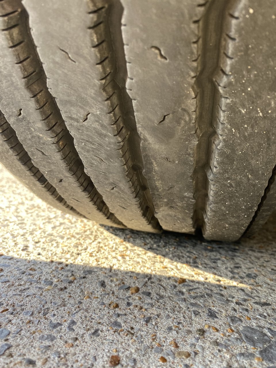

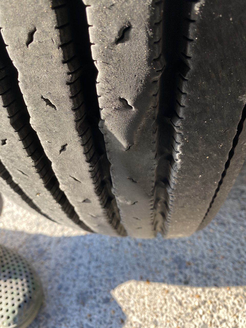

    Read my first couple of posts, did that. Truck just had king pins mic'd a week ago when it was in for a FL bearing (but the first bad tire was on the right). Right hand bearing was replaced a few months ago.
    MPG is great and no heat on the hubs, oil is clean.

    Ok, sorry missed that. If you haven't check tie rod ends, and pitman arm. Check rear bushings on drives. Lastly could be a bad tire.
