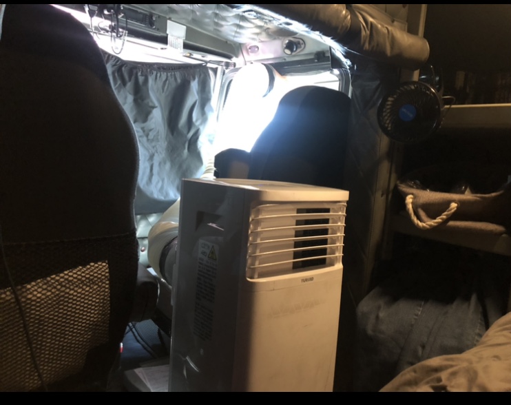

  3. abyliks
    abyliks Road Train Member
    4,138
    9,743
    May 2, 2010
    ludlow MA

  5. flood
    flood Road Train Member
    4,169
    4,050
    Dec 25, 2010
    A few things on most trucks you can mount a 3500 on the catwalk.. a few ratchet straps and (in my case) 2 cable locks around the frame.
    Yes a 2000 predator will run your ac for over 8.5 hrs depending on out side temp.. I'm using mine now because my 3500 stopped working yesterday. Yes I have a 3500 AND as a backup I have a 2000 on my truck... I DONT IDLE.
    My ac is a GE 5,500 btu portable vented out the passenger window like the one your looking at. Sits between the seats with a ratchet strap around it and the seat to keep it from moving.
    The ECO switch. What it does is allow the generator to run at lower rpm when you don't need alot of power (less fuel use and longer run time) but will auto rev up when more power is needed... mime rev's up only when the ac compresser is running.
    Now as to the predator get the EXTENDED WARRANTY.. it is a free replacement warranty and covers it 100% for 2 years. If anything goes wrong just drain the fuel tank and take it to any harbor freight and you'll walk out with a new one in the box in about 1 hr.. others the warranty requires you to find a authorized service center of ship it back (on your dime) to be repaired either way it could take up to 30 days before it's fixed.. Get online and read ALL the warranty info on any generator your thinking about.. I know the Pulsar warranty looks good at 3 years... but if you READ it all 3 years OR 500hr.. that's 50 10hr breaks. What good is a 3year warranty if it's void after 2 months of use.
    Just something to think about
    As to the ac. Think about getting one that has Dehumidifier built in (mine does). You would be surprised at the number of times that it really not that hot just muggy.. a Dehumidifier will take the water out of the air and cool the truck. Mine has 2 drains 1 for the ac (top half) and 1 for the Dehumidifier (bottom half) I have a hose from the top to a "T" fitting to the bottom and then to a hose that I drop out the bottom on the passenger door. You'd be surprised at how big of a puddle I have under my truck when the Dehumidifier is running.
    This has worked well for me for over 4 years. North, deep south, east, west.
    Soltaker and dwells40 Thank this.

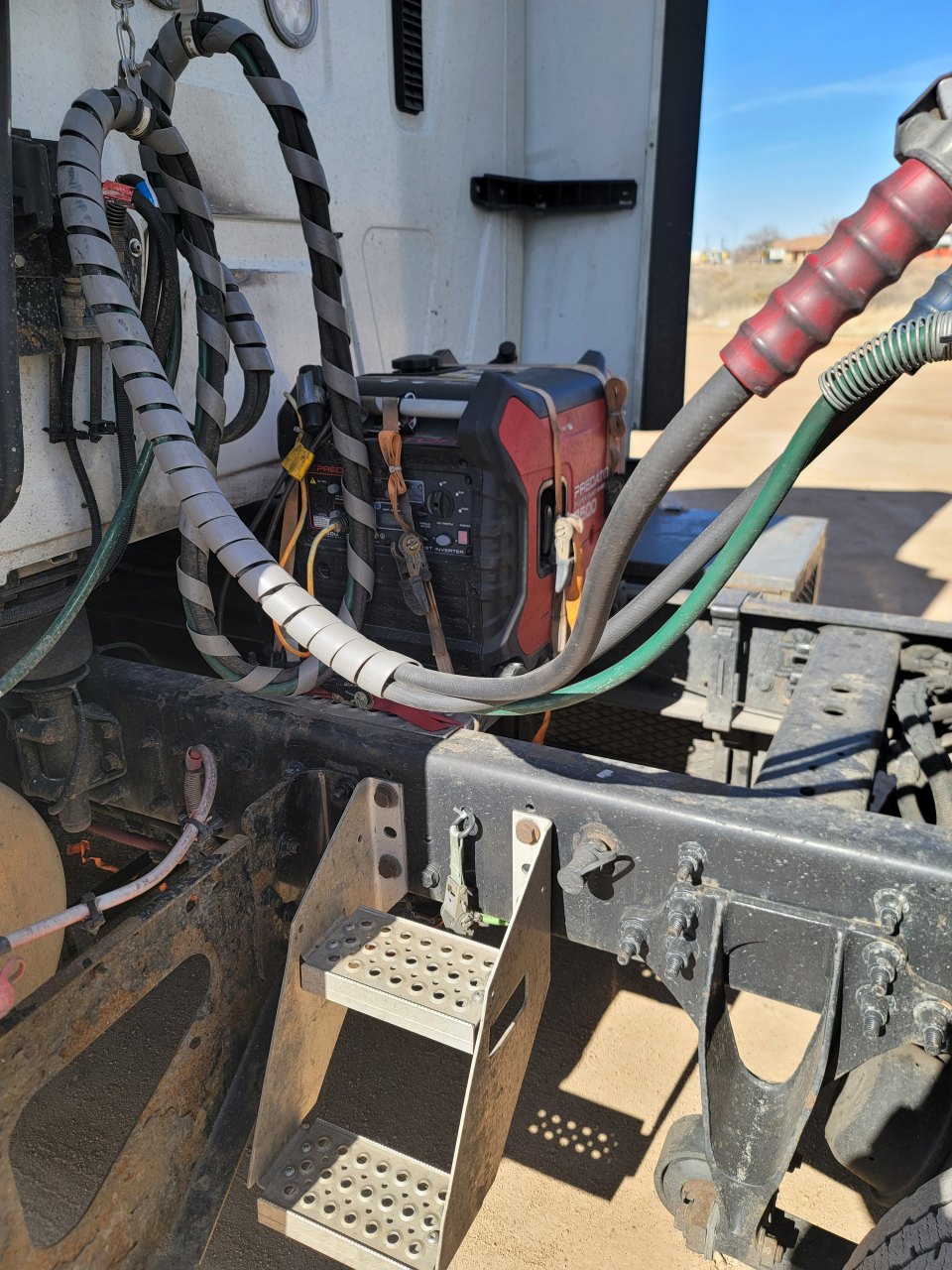

  6. flood
    4,169
    4,050
    Dec 25, 2010
    My 3,500 on my catwalk
    The box I store my gas cans and NY 2,000
    dwells40 Thanks this.
