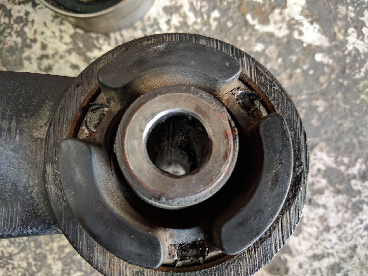

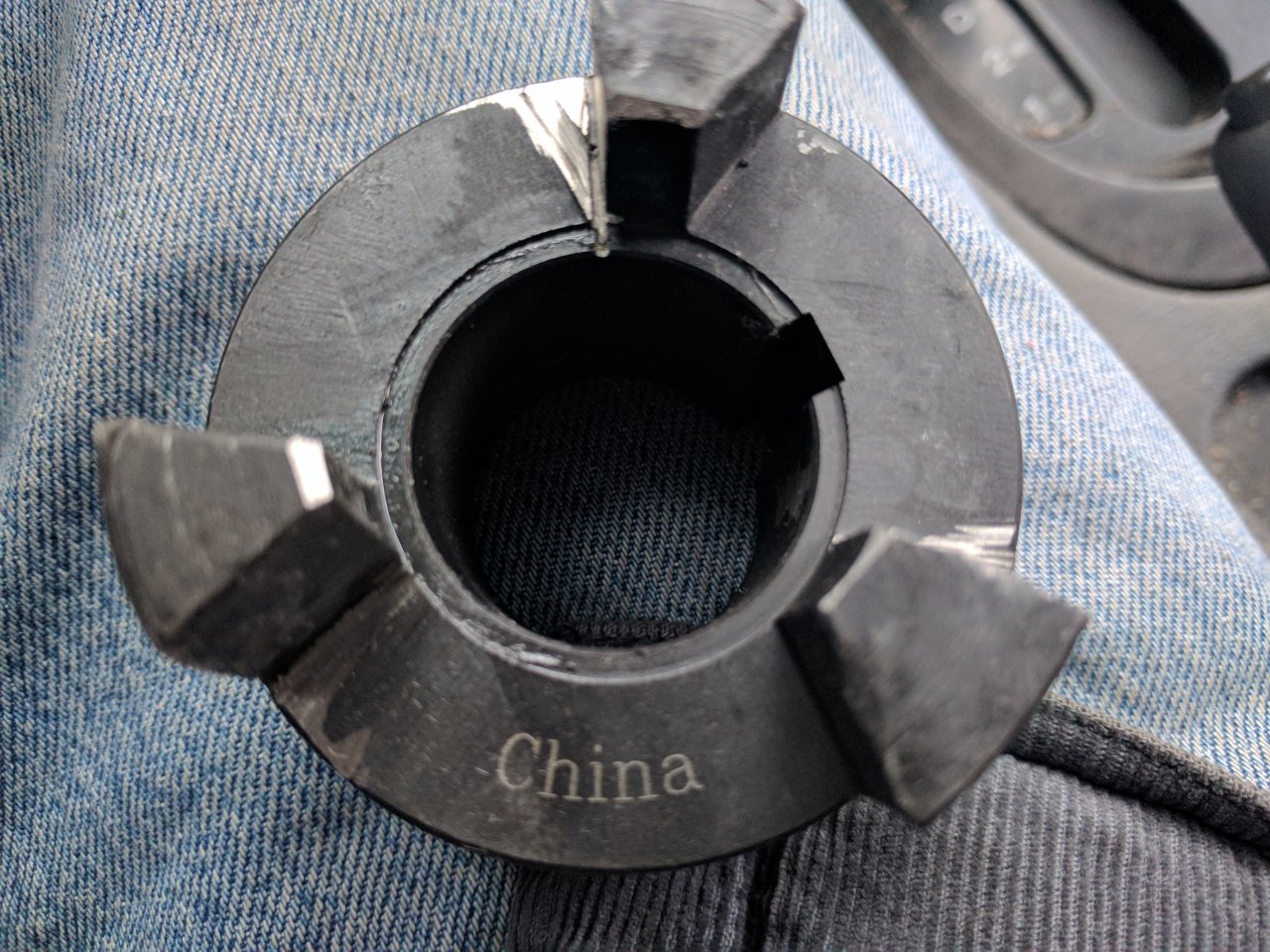

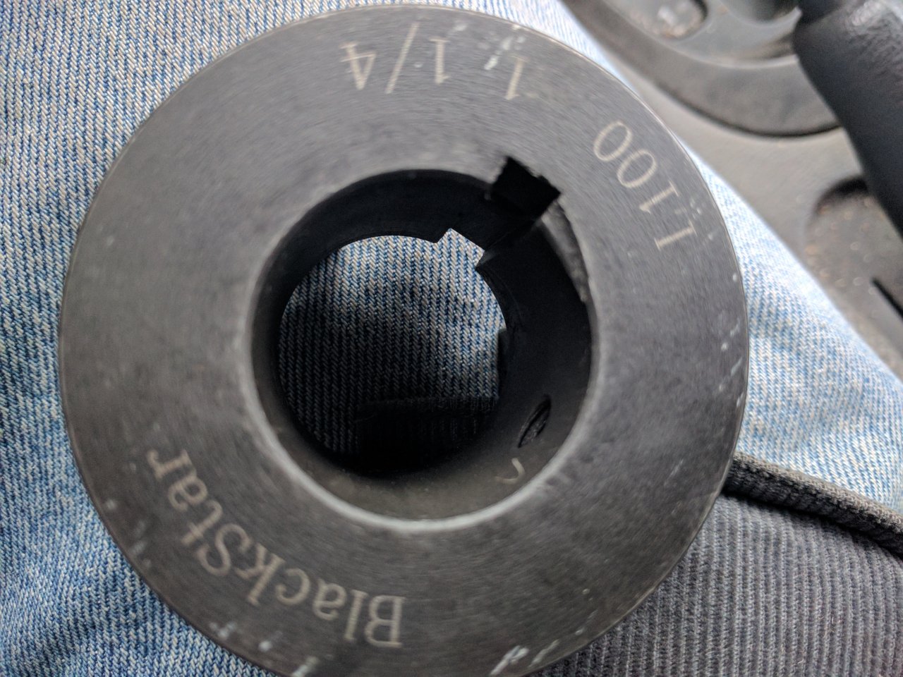

    Just replaced my cab bushings. Took me about 3 hours with some research work and some beer.
    What you need if you decide to DIY.
    1 Good 1/2 impact wrench and 30mm socket DeWalt or Milwaukee
    2 30 mm wrench to hold bolts from inside the frame
    3 24mm socket and wrench
    4 Car jack to lift cab
    5 4x4 post to support cab
    6 3-piece L jaw coupling 2 1/2 " OD ( some grinding require to fit in rubber) from ebay
    7 Shop press or oil jack 5 -10 ton
    8 Good friend IMG_20170316_174252.jpg IMG_20170327_182159.jpg IMG_20170327_182213.jpg help to drink beer
    KB3MMX and Johny41 Thank this.

    Just an interesting video I just watched , ( sorry,in russian) @Time 14.00 shows the tool needed to press the bushings correct without damaging during installation. As i mentioned above, it happened to me, took it a small shop, they pushed the new ones in with a simple circular rod, truck was shaking worst with new cab bushings. I did the job again with bushings preinstalled in cab mount.
