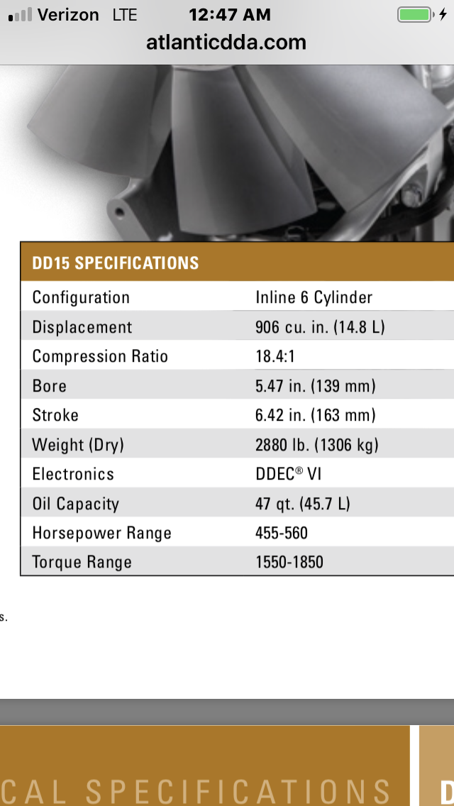

  10. Rideandrepair
    Joined:
    Aug 8, 2015
    Messages:
    17,357
    Thanks Received:
    56,317
    33BEBD77-4641-4F0E-A699-17824EFF1A33.png I just looked up the torque curve for dd15. It’s very impressive. Looks like that engine can run 1800 rpm all day long.Supposedly it’s at 90% of torque @ 1100 rpm. The torque curve chart shows it starts falling, after 1600 rpm. Yet it says torque range 1550-1850. I need more research, I guess.But with the long torque band, and the 10 speed, 1650-1700 might just be the best overall for drivability, especially in the hills.I wonder how much mpgs you’d gain, running 3 mph slower, if any. Looks like 1650, right at the top of max torque, is the best place to be. Now I’m wondering what your hp rating is at, and wether there’s different parameters, to maximize torque at your desired speed.
    Long FLD and Farmerbob1 Thank this.
