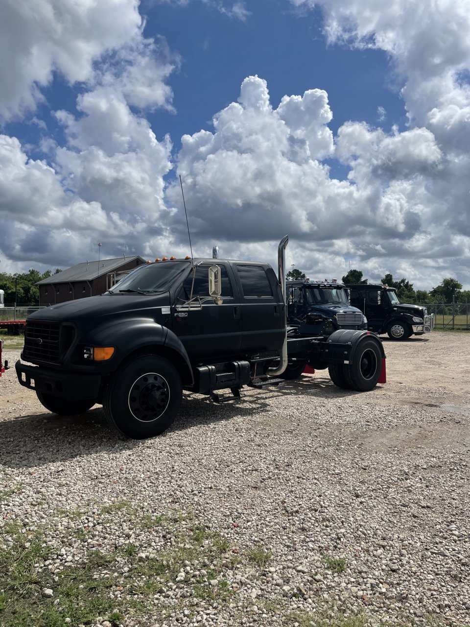

    I just got a 2000 Ford f650 with the 3126 engine. I want to buy the necessary hardware and software so I can scan it and clear codes on my own if need be. Where do I start? Basic OBD2 scanner or does cat have specialized equipment for all this?

    I took it to a local shop. Tech said the ecm was completely custom. He wiped it and reflashed all the factory parameters back on to it. Runs much better now, noticeably at idle and highway cruising, 275HP. One of the previous owners actually swapped in an Allison 3000 series trans, normally these come with an AT545. And I’m still figuring out the rear end. I’m pretty sure it’s got 4.10’s.

    Oh man did my first haul today and she’s a turtle!!! Plenty of pull and braking but it takes forever to get up to speed. I’m thinking the gearing is all jacked up from the trans swap. 157k miles
