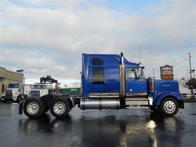

    I had a Dometic Commercial unit on my last rig.
    Going to try a Dometic Penguin this time around, for the lower profile on this, my new truck:
    Friend of mine runs a low profile one on his Cascadia, never had a problem with it. Also know guys that have ran the same window AC unit for many years without a problem. Not like you go down the road with it hanging out the window...:biggrin_2559:
    As far as the split systems go, I think they would last just fine on a big rig, seeing as they are made for them!
    I got a quote on one, @$4700 for a new 14k BTU one, or $1495 for a used 14k BTU one. Both plus shipping! Not worth it to me, especially seeing as it is about physically impossible for them to be as good as a rooftop unit of the same BTU rating. Cool air falls, hot air rises, no way around it.
