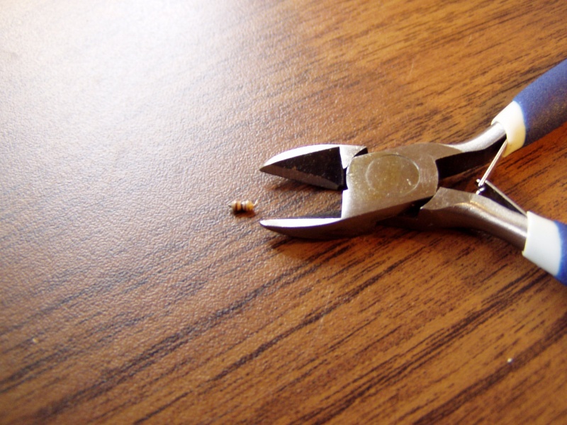

pretty sure thats what he took out of my radio and replaced it with some wire

If that is indeed what he did, he just butchered your radio. You might see more watts but that's because your radio is now distorting, which means you're bleeding over into adjacent channels. Those extra watts are harmonics, aka dirty distorted sound over the air. All your CB buds probably tell you about that "crunchy audio". Smooth is where it's at.
He might be a decent dude, but the true reality is most CB shops dupe truckers and the uninformed, about how they can make a stock radio, with no amp, somehow push out 100 watts and put all the big strappers on channel 6, on lock down. They do this because they know you'll most likely buy into it and chances are you wont be back anytime soon.
Ever wonder how much the parts for a swing kit cost, and how easy it is to put in? The CB shop knows, and he makes one hell of a profit everytime he installs one, besides selling you something you really don't need.

How much did he charge you??? Just have to ask because I would have done it for free. That is what I call a back yard tune up. It is all that is available in North Dakota unless you want to ship your radio out to someone. We don't have any real radio techs in North Dakota. But you do know that the same thing can be had just by cranking the mod limiter pot fully counter clockwise. I don't go more then 3/4 a turn personally.
