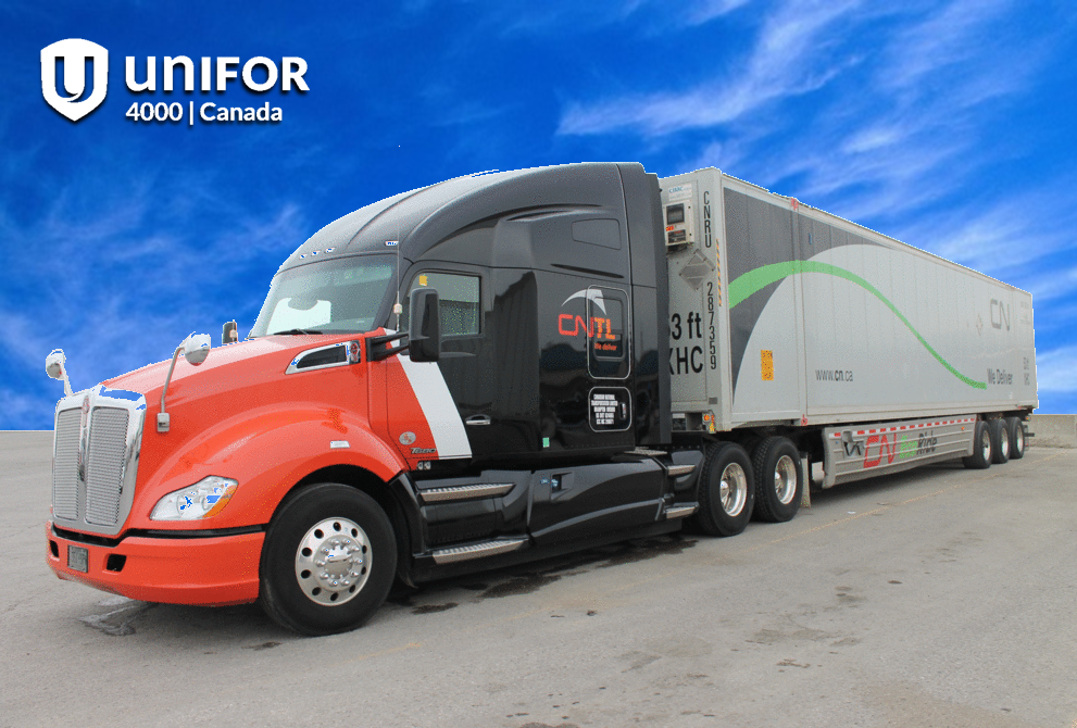

    A container pulls a lot harder than a van, just from the sides on the., so fuel mileage would suffer too.

    Doesn't that depend on whether or not the container has ribbed sides?

    It would, I don't think I have ever pulled a smooth sided one.

    Most of the domestic 53's around here tend to be smooth-sided.

    There you go, I have pulled a lot of containers, never even heard of a domestic one, and sure never pulled a smooth side. I stand corrected.

    There are domestic boxes.
    International boxes carry big stripe somewhere on them.
    Or is that the other way around. I forget.

    Originally 20' and 40' boxes were the international standard; 53's were domestic (aka North America only.) I don't know if anything else had changed.

    I have no clue where people get their numbers but this is the third time I read a forum post like this.
    here is what I have.
    A standard 53 trailer tare weight - 15,450 lbs
    One of the lighter 53 foot container on a trailer tare weight - 19,780 lbs
    Those are actual numbers from weighing them.
    The containers itself can be between 9800 lbs to 11,000 lbs.
    I have several and a few trailers.
    Would I use them?
    No.
