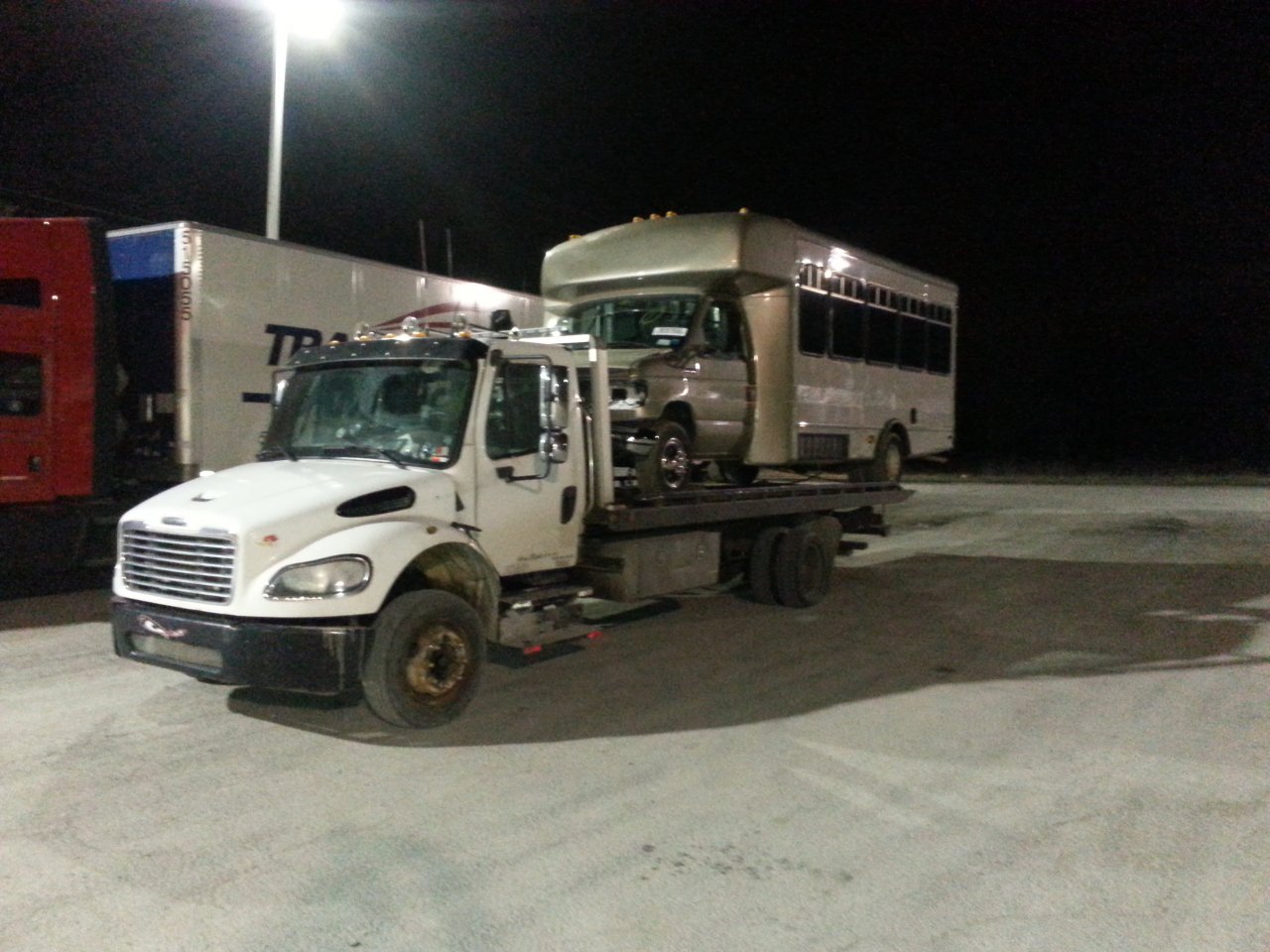

Anything wrong with this securement?

    After I pull these up and level, 4 point securement front and back, and a safety chain,
    I take a chain from his drivers side frame to my opposite side frame w/load-binder.
    Criss-cross them, and tighten each screw load binder, to compress the springs some.

    I always prefer to grab the axle or control arm. Something that takes away the suspension from the securement. Just a comment, not a criticism. Wheel straps work awesome too.

    whats the hammer for? lol........

    Sorry,
    Not clear originally I guess; yes, that is where the 4 point securement mentioned is.
    Never used wheel straps, except on rear wheel lift. Was thinking of getting 4.
    Big top heavy stuff I do the extra mile, to stop the sway from the towed veh. suspension.
