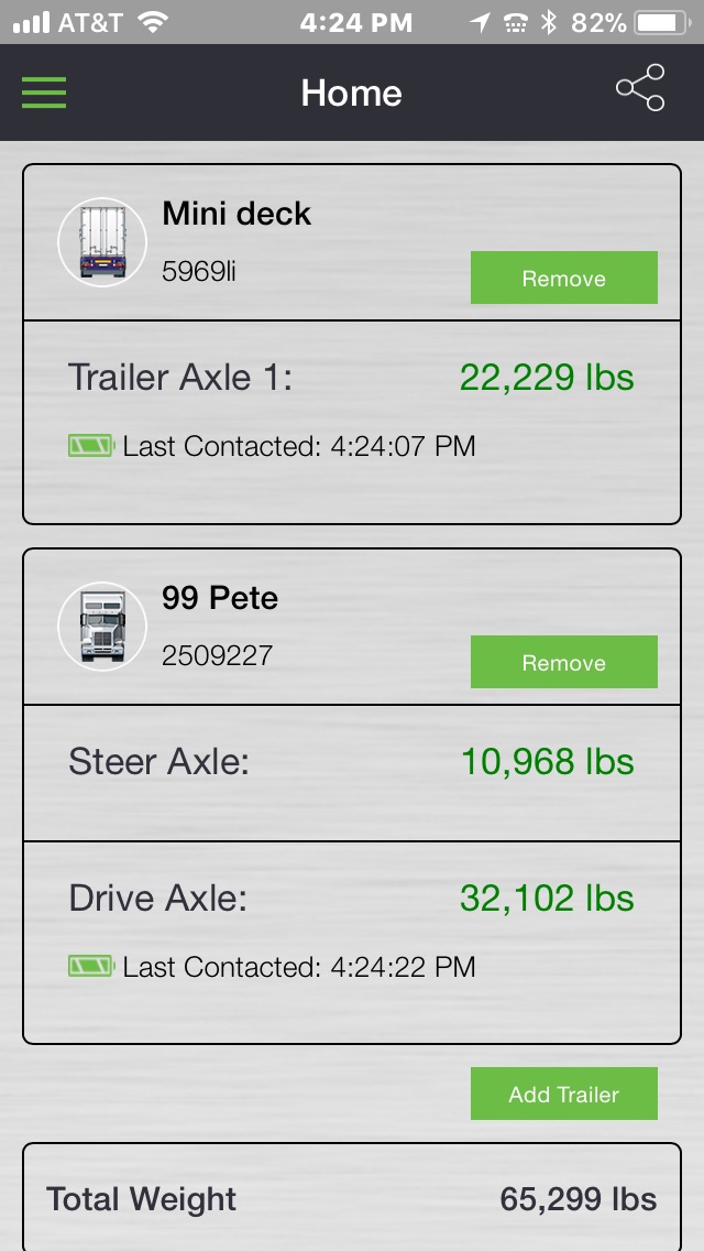

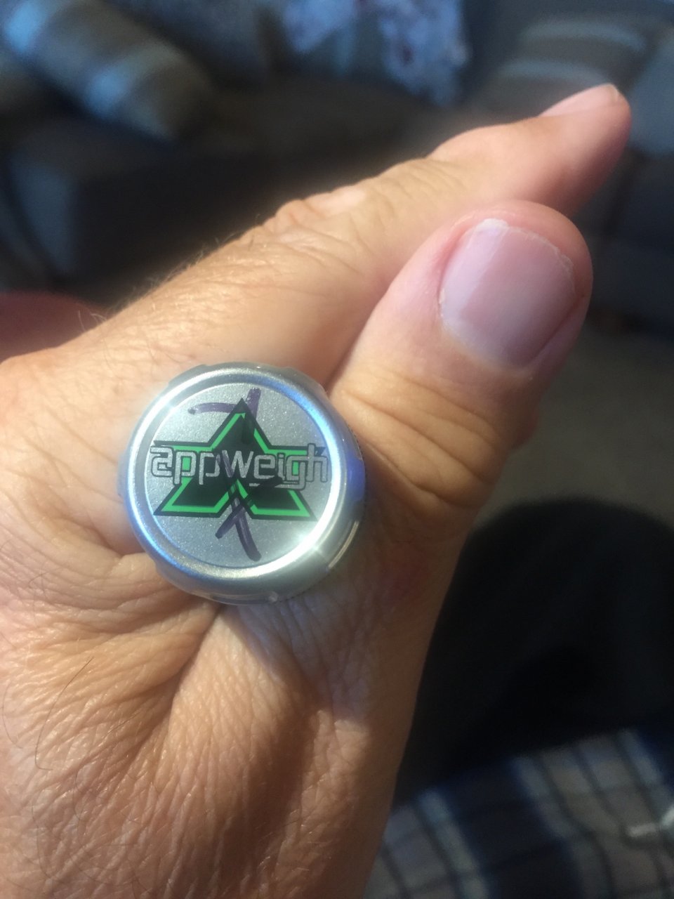

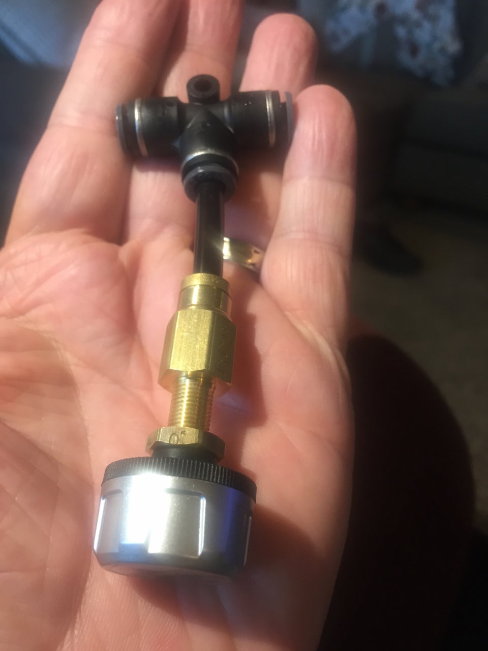

    I use it, usually within 200 lbs, easy to install, took longer to find my tubing cutter than the install took. Buy a cheap cutter so ends are square and won’t leak.
    Turn off your other Bluetooth devices if it doesn’t want to read.
    I still have my gauges just in case, I load a lot with a crane and don’t have much chance of shifting load after the crane leaves.
    I like not having to cut into wiring harness to install.

    They’re okay but can need periodic calibrating because of the added conversion and translation required. I personally prefer just your basic pressure gauge setup. Tractor and/or trailer. Less to go wrong. And it’s universal. No app required. If you drop your phone in the toilet, your gauge weight readout will still be accessible
    But the negative is they can be trailer specific with regards to pressure to rough pounds conversion. So drivers unfamiliar with gauge (equipment) may not know what’s what unless they are some how documented with paper and pen

    Interesting that it calculates for the steer axle, or do you have air ride steer? It looks pretty handy!

    It "estimates" what you might have on the steer by what it thinks you have on the drives, and using a basic math multiplication factor that is determined at calibration time (assuming you input good numbers, and do the calibration process correctly) and going from what is known light, versus what is known heavy and assuming you don't shift the 5th wheel slide any. Doing so will render the math formula generated at calibration, no longer valid.
    But the steer estimate is never really a concern for most once they understand their configuration and leave it alone.
