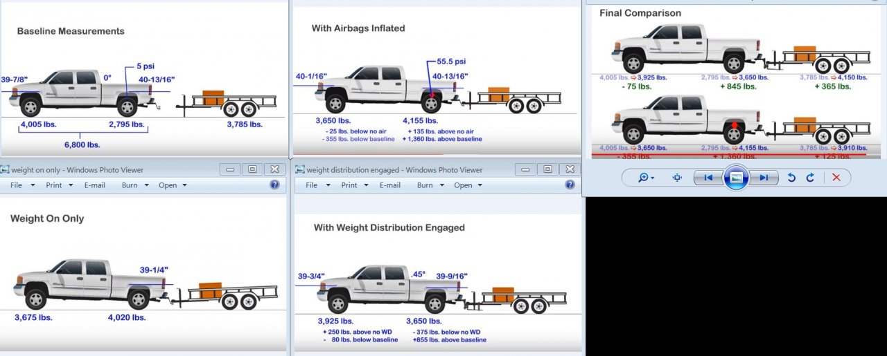

    By lifting the rear so that it is level some weight will be moved forward. Pretty much the same way that load leveling bars (also called spring bars) work on a bumper pull trailer.
    See this link for some additional info. Most relevant info is found directly under the picture of the rig before / after the bars are put on. Notice the front wheels of the truck are barely on the ground. After they are firmly on the ground.
    Equal-i-zer Weight Distribution System w/ 4-Point Sway Control - 4,000 lbs GTW, 400 lbs TW Equal-i-z
    ANOTHER THING THE AIR BAGS DO THAT I FORGOT TO MENTION... by keeping apeopriate weight on the front end you have much better steering control. With the front end unloaded and barely on the ground you risk loss of control pretty easily. I have heard many reports from wedge guys that they tried to turn but the truck just kept going straight.. because of not enough traction on the front tires.

    Not meant to be argumentative, just for sake of disscussion.
    I pulled a 50' kaufman wedge for a while and never had a problem of not being able to steer the truck.
    Anyone that has pulled one with a fifth wheel hitch can tell you how easy it is to overload the rear axle of the truck on a 3500 or 350 which puts the headlights out of line and will get you flashed with bright lights from other drivers.
    You are talking about two different things here. Air assisted suspension and weight distribution hitches.

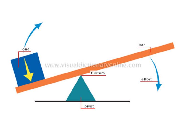

    Fifth wheels have three load points, air bags at the rear suspension only moves weight up and down. Weight distribution hitches has four. The fourth (the hitch behind the truck) makes the rear axle of the truck become a fulcrum point which at some point when (over loaded) can start to lift the front of the truck. That's where weight distribution bars come into play. They help spread the applied load from the hitch behind the truck to the chassis on truck and trailer and bring the front of the truck back down. Air bags only lift the chassis at the rear suspension an help level out the truck. They may shift some weight but very minimum at best. I'm sure they give a better a ride and have other benefits as well. I am currently looking at putting Kelderman's suspension system on a Ram 5500 now. Don't if it's worth the money and if it will affect the Hitchcrafters application I have now. You can watch a youtube video here
    or look at there pictures below.
    Another source Weight Distribution Bars and Air Springs
    Weight distribution bars used with Air Lift air helper springs (also called air bags) provide maximum stability and control of your towing vehicle and trailer. Air Lift air springs provide load assistance for your sagging vehicle, and the weight distribution bars redistribute the load and balance your vehicle.
    In many situations, heavier weight distribution bars are used to remedy weak suspensions or when additional cargo in the vehicle causes it to sag. Doing so will result in an unbalanced vehicle, excessive tire wear, and an uncomfortable ride. Add and adjust the correctly sized weight distribution bars to solve your weight balance problems and then add and adjust Air Lift air helper springs to fix your suspension problems.

    Not taken as aeguementative at all. Pretty well though out discussion..
    Ill just say i don't fully understand the physics of it but i have personally seen front wheel lift and I have talked to several people with rear air bags and thet report no such issues once the bags were installed.. Not sure exactly how that works but it sure seems to be effective..
