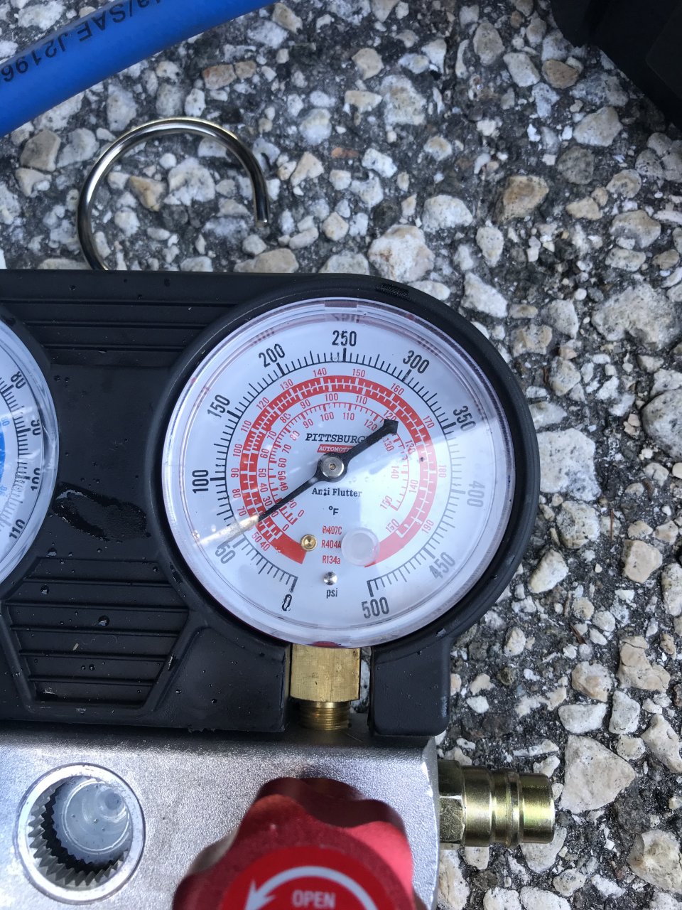

  11. PE_T
    PE_T Road Train Member
    When I checked the high side this morning (before turning on the APU) it registered 55 pressure. I was able to get a few more ounces through the low side, but the compressor is still not engaging. I also noticed right before the APU turns off, the fan that is mounted on the back of the cab next to the drier will kick on for 3 seconds, then the APU turns off. The other fan next to the APU engine doesn’t seem to be running, but I also didn’t check it too often.
