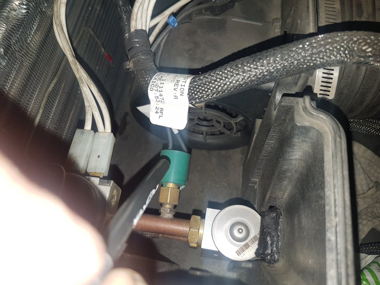

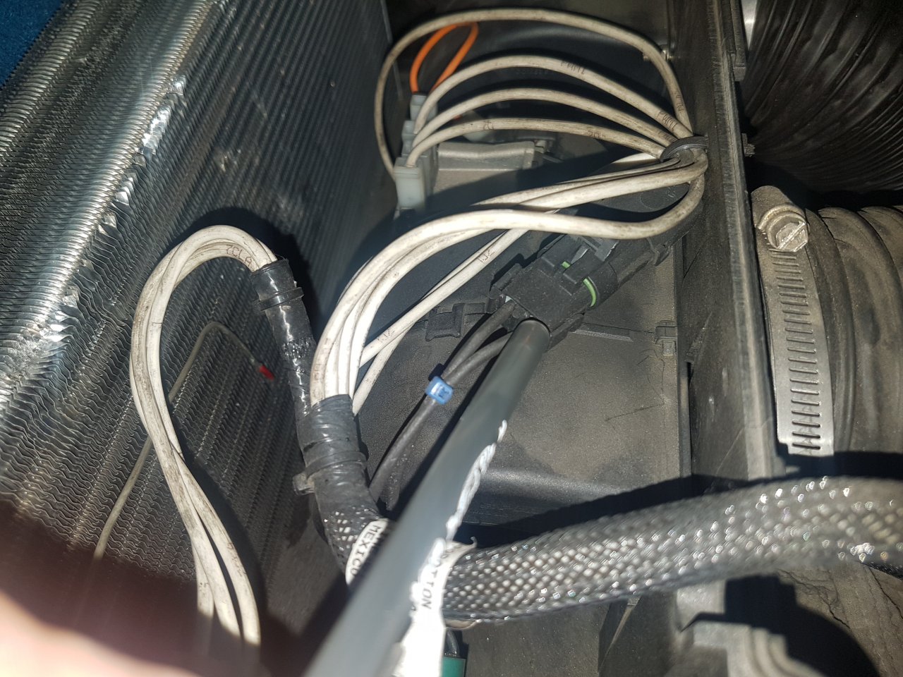

  4. mhyn
    mhyn Road Train Member
    4,255
    4,515
    Dec 29, 2008
    Northridge, CA
    here is he switch that is located in evaporator box
    PE_T Thanks this.

  6. lilillill
    lilillill Sarcasm... it's not just for breakfast
    5,642
    13,472
    Nov 7, 2007
    Possum Booger, Alabama
    That is a low pressure cutout switch which turns the compressor off when the pressure in the evaporator gets too low. The binary switch is located on the drier on the back of the cab.
