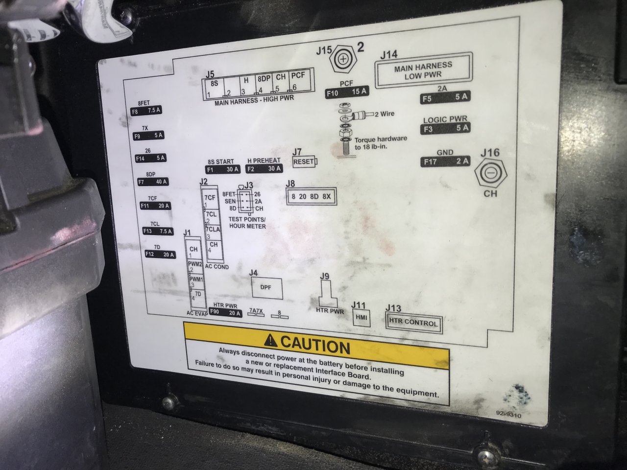

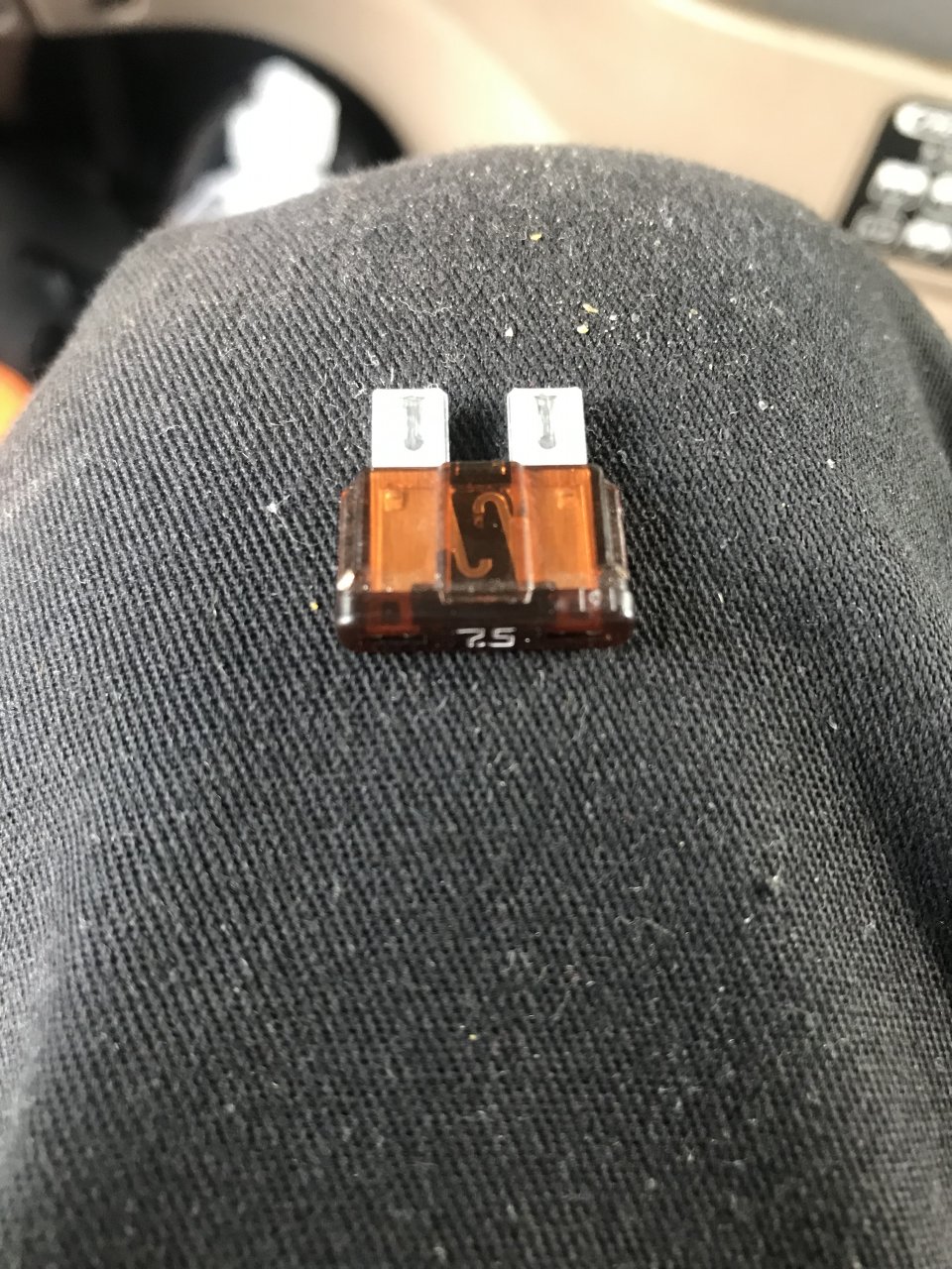

    F13 is the clutch fuse.
    PE_T and mhyn Thank this.

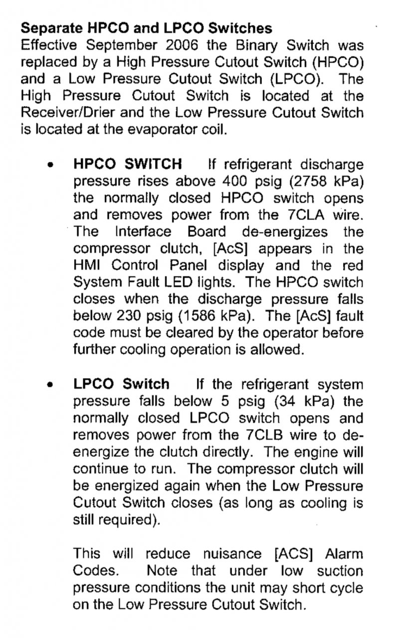

    And I know you said you're done working on it, but I just found this in the manual...
    That means the switch on your drier is not binary. It only performs high pressure cutout. Therefore is likely the cause of the alarm.
    PE_T Thanks this.
