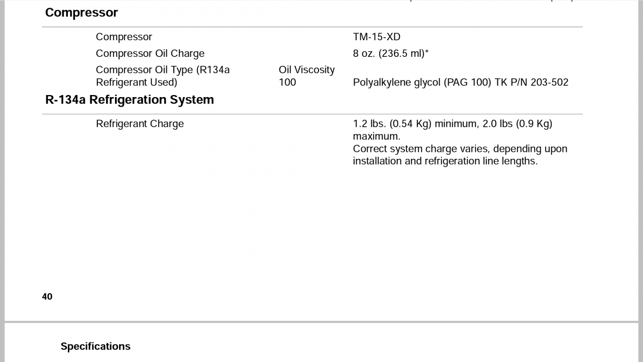

    I’m starting to think the reason why Koon Trucking used 25.76 was to perhaps compensate for the freon left behind in the manifold hoses. I remember reading in a TK owner’s manual that the freon can be from 1.2 to 2 pounds, depending on the length of your A/C lines. I used somewhere between 23-25 ounces. I did not have an accurate scale. It was one of those food scales that lowers when you put some weight on it. Hahaha.

    The cans you buy at the store are 12 oz. Two of them are good enough.
    A scale is used when you are charging from a 30 lb tank, though that's kind of outdated. Modern AC machines will remove the old refrigerant, vacuum, collect any oil and reinject the same amount of fresh oil, then install a proper charge all automatically.

    Next time I’ll buy two 12 oz cans so I won’t have to weigh anything. One of my cans had 20 ounces.
