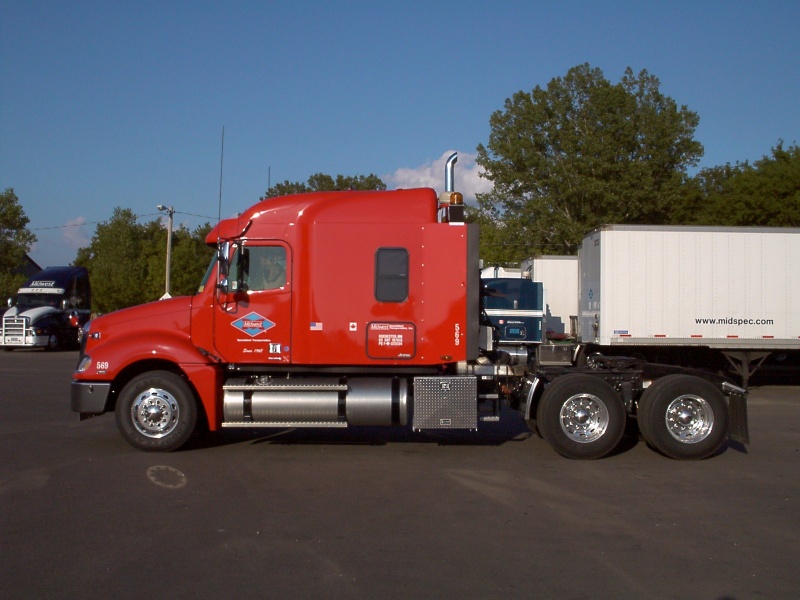

Wow....geez.....do you have a headache rack? You may have to go on the catwalk....Gotta lose the steps also.....wow...thats gonna be tight buddy
headache rack yes mate. I pull an RGN.
Nop catwalk really, just a piece of 2x6 on the rails. Not a lot of room there neither!
I figured on removing the steps on the passenger side for sure, with the driver side a possibility.
Only other option is to lose either a 150gallon tank in favor of a 120 gallon tank, or trim a tool box down. Both tool boxes are completely full, so........
Martin
