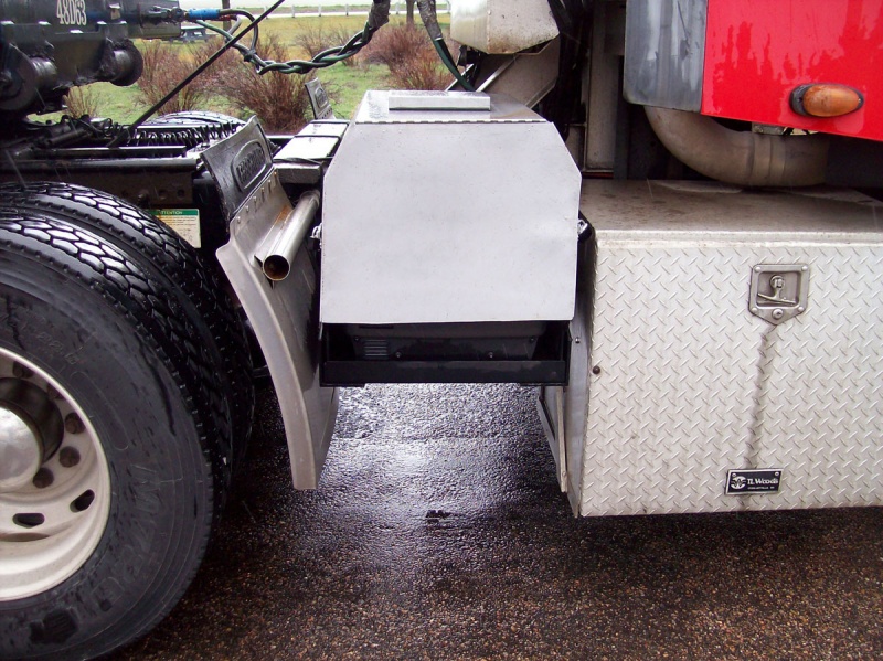

    Sorry it took a few days, but here is the generator:
    Mounted it higher to make changing the oil easier, and to allow me better access to the underside of the truck. Not a lot of room along the sides to get under there on a creeper before this!
    The front door is a temporary thing, I ran out of time and materials! An aluminum diamond plate door will follow with louvers in it to let it get some cool air etc. New door will also go all the way down, with 2 breaks in it to follow the curves of the sides/top which is all one piece and attaches via 4 bolts with welded nuts on the inside. The front door is also lipped, closing the sides off too. I used some vacuum line with a slit in it to put over the metal edges. Will see how it goes, and if it doesn't hold up I will get some bubble gasket for it (no one local had any in stock).
    The box on top of the enclosure is hinged like the front door, with a piano hinge. Lift that up and there is the fuel gauge and cap.
    The brackets are 4x4 1/4" angle iron, bolted to the frame with existing bolts/holes. All gusseted too.
    There is a 3/16" tray that the generator bolts to using the existing generator rubber feet holes, the rubber feet are still in place. The tray is broke to the correct size, with a cutout for the oil drain in the rear. 3/16" plates were then welded to the sides, between the front and rear uprights of the tray. One of those also has a cutout to give access to the spark plug and air filter.
    The tray is secured to the angle iron brackets with 4 grade 8 bolts, nuts are welded to the inside of the tray.
    Took a day to make the brackets etc, and then I removed it all to paint. The top and front are painted with high temp primer and paint. Everything else got hit with spray on bedliner.
    Also ordered a pair of 250lb sliding hinges to enable me to unlatch it and slide it out for service etc. Right now I have to unbolt 4 bolts from underneath and then slide it out on the brackets. Maybe takes 3 minutes including finding the 1/2" socket.
    I will end up wiring the truck for it instead of running leads. I am thinking of 2 block heater style plugs at the rear of the sleeper on the outside. I can then just run a very short extension from the generator to them and leave it, or use shore power to power everything inside. The ac unit will be on one plug, everything else or the block heater on another.
    Right now I am just using a portable ac unit from Lowes and a portable Honeywell heater from Wally World. No one local stocked the ac unit I wanted so will order it via the internerd, along with the heat strip for it.
    Figuring it added @200lbs to the truck fully fueled and with the brackets. Not bad when I can get a 400lb allowance in most states:biggrin_25523:
    Constructive criticism always welcome.
    Martin

    Forgot to add. I have under $2600 in it all right now including the generator, steel etc for the box/enclosure, the portable ac unit and the heater. Not bad considering EVERYTHING is under warranty (3 yrs on the generator itself, 1yr on the ac unit and heater).
    Will be a little more when I get the rooftop ac unit, but that isn't needed for everyone.
    The genset could have been mounted to either a catwalk or the frame on brackets along with a $30 Honda cover, but I have very limited room and wanted it done permanently. Brackets would cost @$50 to make IMO, using existing holes.
    Martin
