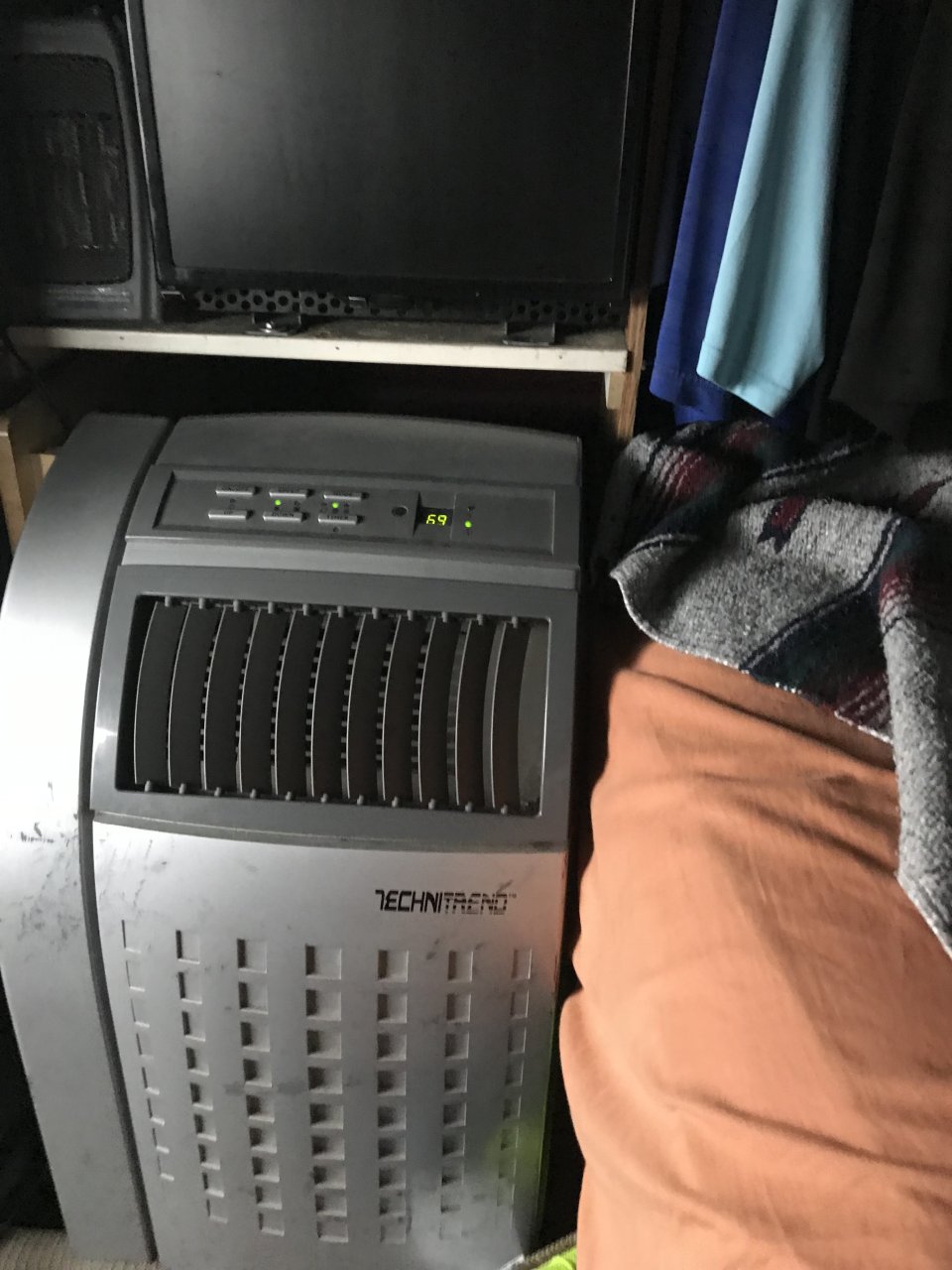

    Nice. Can you show us your a.c.?

    Could look something like this?

    N
    Not as fancy as yours.
