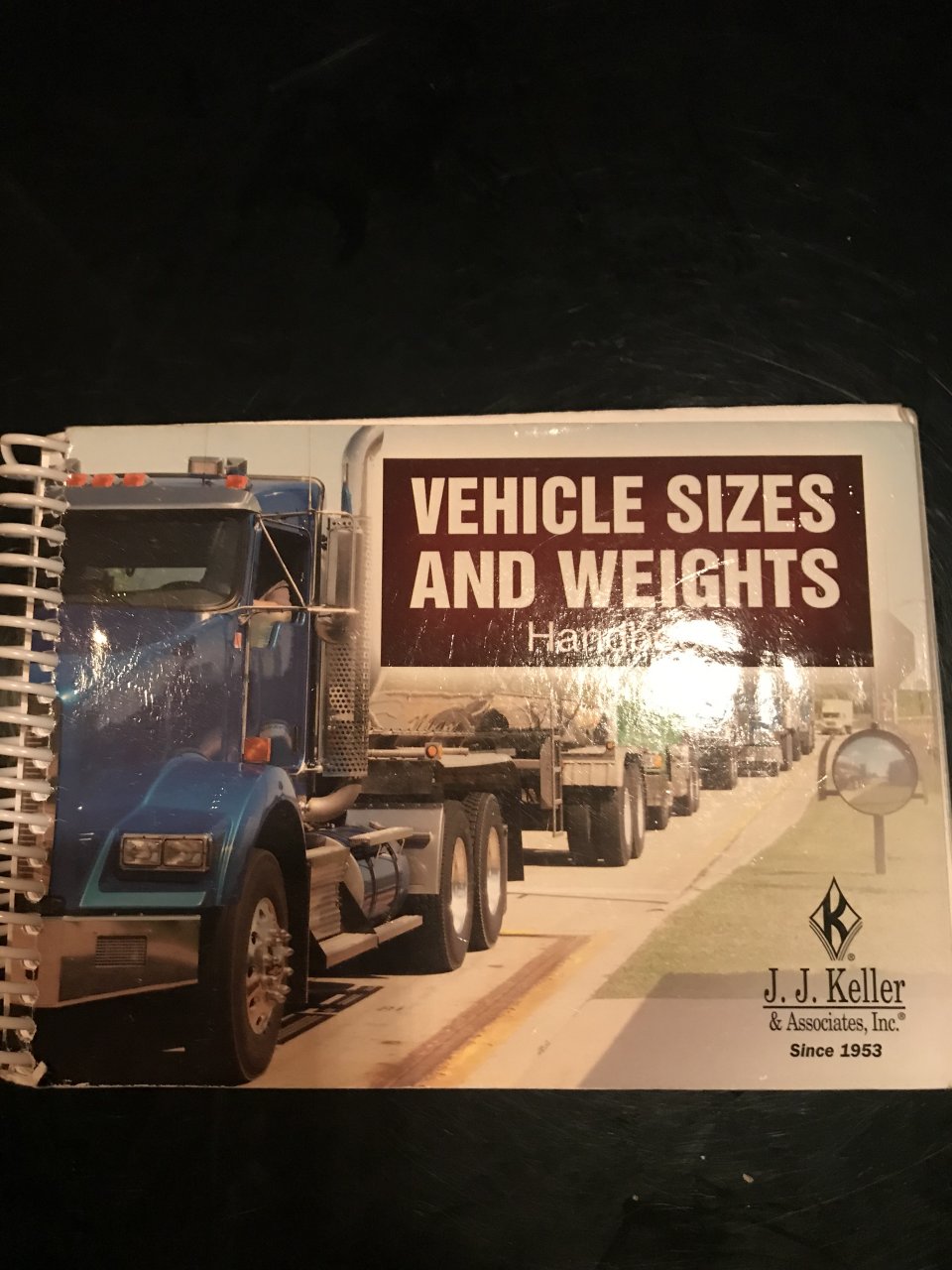

    CB46BD33-17D9-4E64-8E0E-3912E5D7DD2F.jpeg best little book to have
