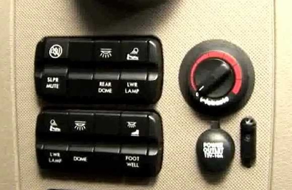

    APU's I've had were supplemented with oil fired Bunk Heaters such as Webastos, Espar etc. For example, on a Webastos unit, it may have a separate control which looks like a dial. The truck has to be off and not running in order for it to work.
    Lift up your bottom bunk and have a look. If you have a square looking box with ducting tubes coming out of it, that's part of the APU A/C unit. Look beside it. If there's another box, usually rectangular in shape, and a vent coming directly out of it and located on the under side of your bunk, that would be your bunk heater.
    You can also check the bunk area for separate heater controls. The images below may or may not be what you have, but no harm in checking. The one on the left is for an Espar bunk heater and the one on the right (The Dial) is the control unit for a Webastos bunk heater. Could be a digital control for newer units. It may be located just below the bunk as well.
    See if you have something similar and more help could be provided whether you have this or not. Just need to know more info.

  10. kidnya
    kidnya Bobtail Member
    40
    8
    Mar 8, 2013
    Got it. It was the knob on the bunk and turn the apu off and heat is coming out a separate vent!! Thank you very much for your help!!
