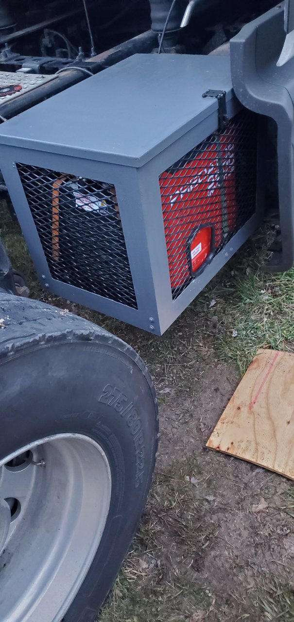

    I have a predator 3,500 on my truck.
    Just as quit as the Honda eu3000.
    Will run my portable ac for 11-12 hours on 2.5 gl.
    Had it on my catwalk all summer but with winter I had a custom frame mount box built.
    I added and wireless remote start/stop kit so no getting out of the truck in the cold/rain/snow to start it.
    In the spring I'm adding a remote fuel tank (10-15 gl) so I'll just drop my trailer and go to the gas pump once a week and full up...
    Get the 2 year extended warranty Well worth it.. covers it 100% for anything except lost/stolen... if anything goes wrong at all just drain the fuel out and walk into any harbor freight with it and walk out 15min later with a new one in the box...
    This is mine in it's custom frame box

    Nice! Did you fabricate that box yourself? Looks very professional. I spent 30 years in the construction trades. I have seen enough hack jobs to see the difference. The dirty little secret about the Predator vs Honda is...........get ready for it..........China stole the design from Honda!!! All of the Hondas are probably made in the same Chinese sweat shop/ labor camp as the Predator! Lol

    I had a local shop built the box to the size and venting I wanted...
