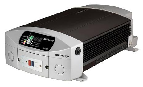

Was your APU already installed on your truck?
Reason I'm asking is that Xantrex model is standard with Tripac's and has been for a while.
