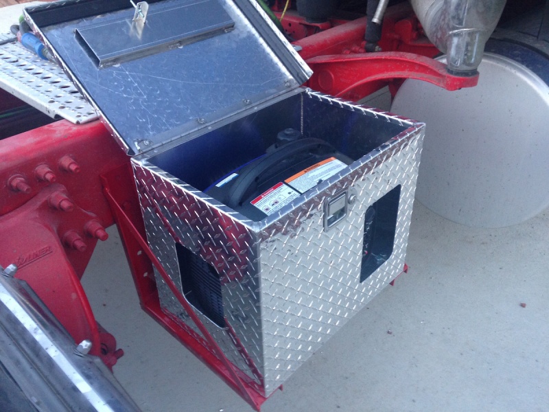

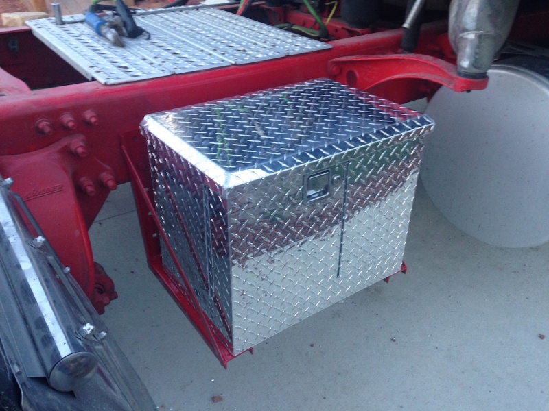

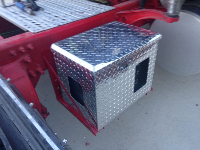

    It all depends on how much one needs an APU. I stay primarily in the upper Midwest, year round, so my air conditioning needs are not a critical. I have a portable generator, mounted in a custom box on the frame rail, that can run right in the box, out of the weather, and secure. A gallon of gas for 10 hours running time. Keeps the batteries charged up via a Xantrex inverter/charger unit, keeps the engine oil toasty warm on the coldest of winter days with the truck engine off, and a Webasto coolant heater on a timer will have the motor warmed up to 120F in about an hour even at -30F, and will do most any window style AC unit if one wanted to use one. Mine is a Yamaha EF2000 generator. Great little unit. If I was in need of serious AC, I would get a roof mounted RV style unit and go with that. Perfect for those that have mid roof style sleepers. Requires more like a 3000 watt generator than my 2000 if I did that. Compare the pricing... A roof AC unit, with a portable generator is going to be less than 1/4 of the cost of a full blown APU, weighs considerably less, and less expensive to maintain. Even if you had to replace components, it is doubtful that one would ever lose in the end doing it this way. And done right, doesn't look tacky like some "red neck", backyard setup held together with duct tape and baling wire. here is my generator box and generator.....

    Not sure how the other crap ended up in that post. Just ignore.

    Cowpie 1 I was wondering what the pix had to do with the post. Nice looking set up too.

    Thank you for the pics.
    I was going to do something similar but mount it up on the top of my headache rack.
    Looking at your set up there,.. I think I am going to mount mine like yours, except add a space to store a 5 gallon fuel can as well. I have a shop near my home that does excellent metal work. They did a battery box cover for me for $275 and it looks better than a factory box and 1/2 the price.
