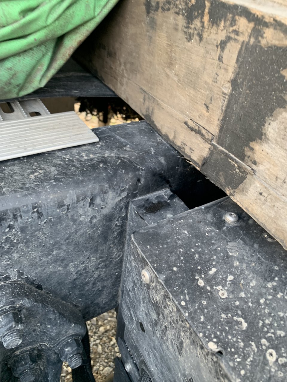

    Yes, just use a heavy wall tubing. My truck has spacers and they appear to be solid but that’s not really necessary. IMG_6200.jpeg
