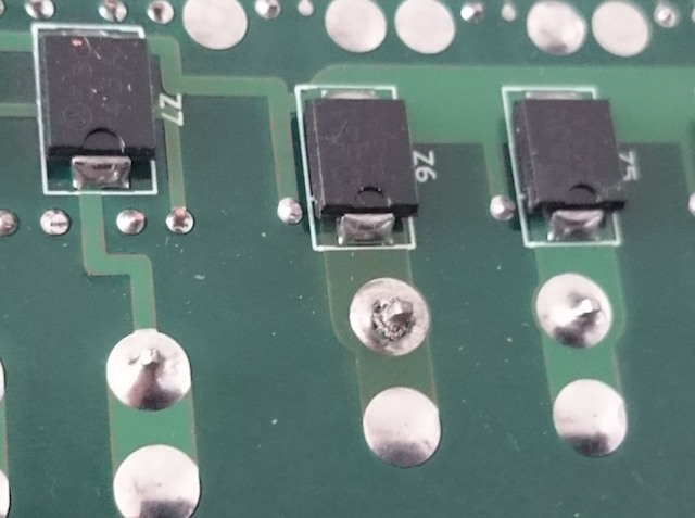

    Pack your patience and take the time to cover the details. Sometimes these things can be tough to find. I chased an intermittent shut down problem for nearly a year and finally found the culprit that I never imagined. This was on an 04/2006 production, original version zero board. That failed solder joint (on the back of the board and not visible) was randomly interrupting the run relay causing the apu engine to stall. I discovered it accidentally by happening to press on the control board in the right spot while the engine was running and could recreate the stall.
