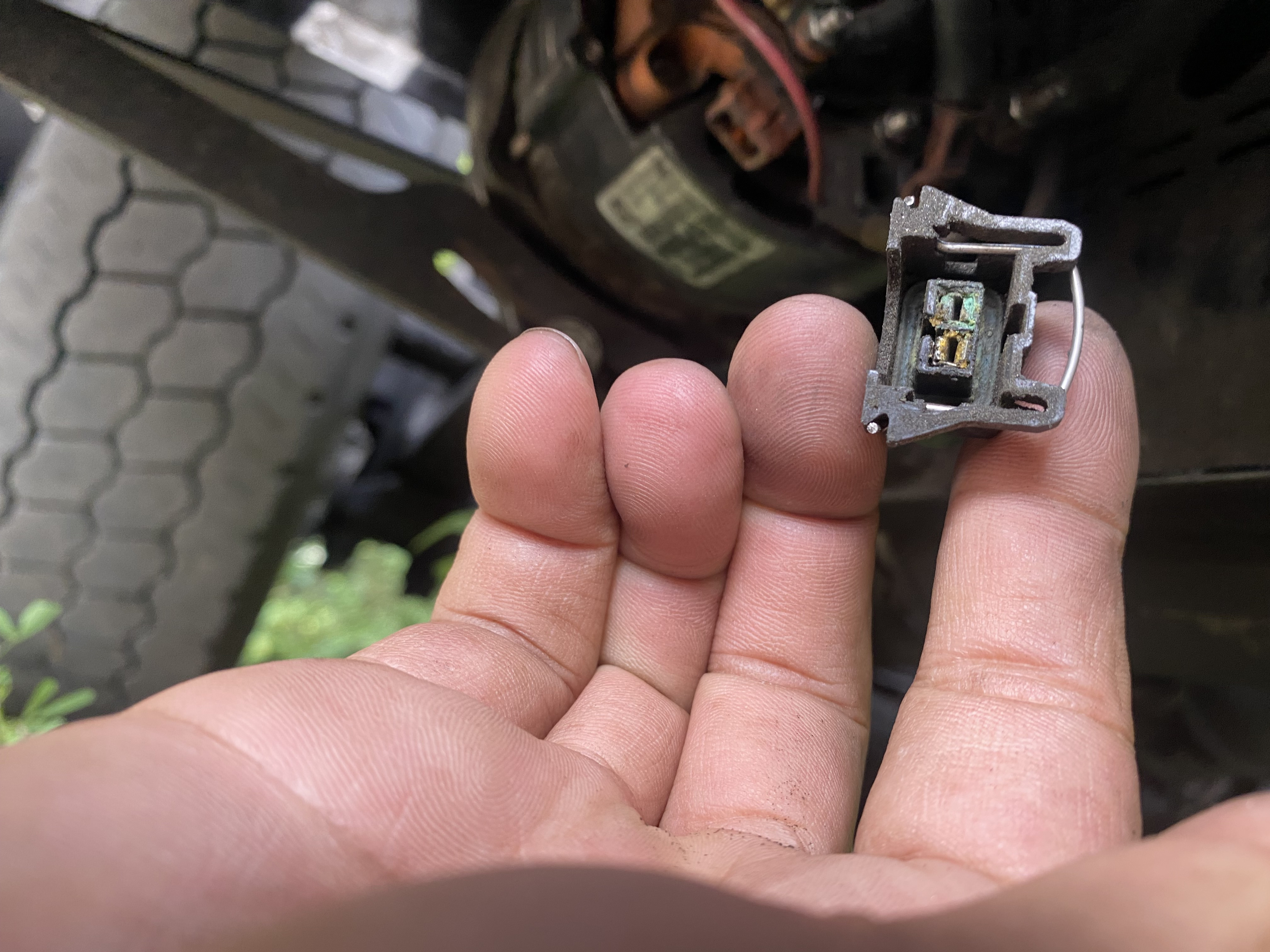

  6. Strbl
    Strbl Bobtail Member
    8
    Mar 18, 2024
    Since the battery, ground and fuses are good I’m wondering it’s the sensor or board.. I checked the board and it had green flashing lights and around 12.4v only on ONE of 6 pins from the white connector [​IMG]
    I’m wondering if replacing this sensor will do it
