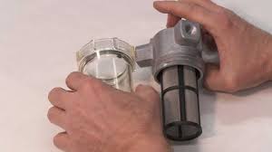

    Afraid your probably looking at an electric pump went bad, i brought up this idea of changing to the strainer, because instead of removing fuel lines and possibility of them being left loose and causing your current issue, you only unscrew the sediment bowl.

  3. jason6541
    jason6541 Road Train Member
    2,425
    5,366
    Mar 5, 2012
    Omaha, NE

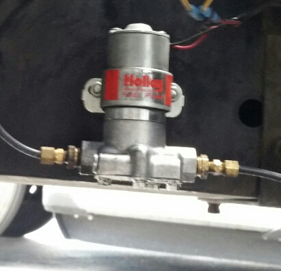

    Hi. Did you remove the original pump?

    Yes, I did remove the original pump. And as an update to this, the Holley died after about six months and I replaced it with a Facet solenoid pump from NAPA. That one was still working when I sold the truck a couple of years ago.
