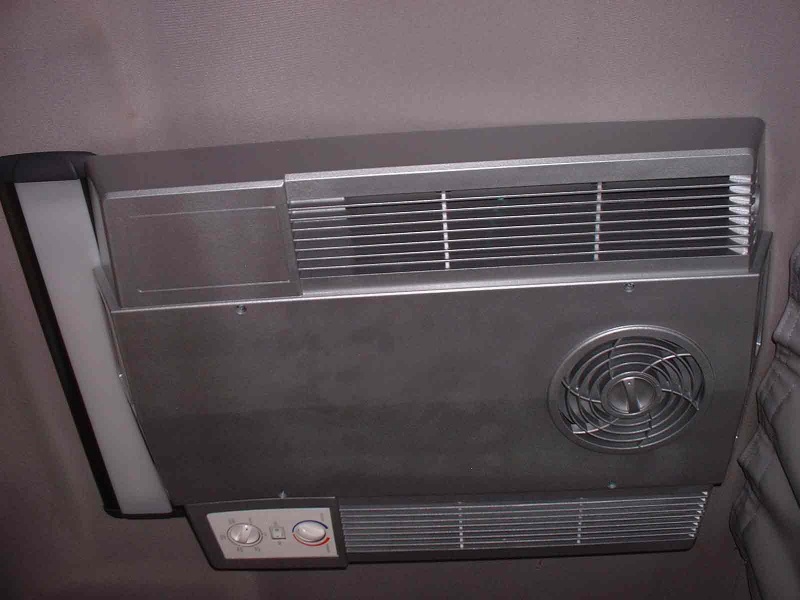

    here is my setup. rv generator with remote start , roof a/c & heat , 13 gallon gas tank. 2200.00 awesome:biggrin_25519:

    why did you mount the roof unit backwards?
