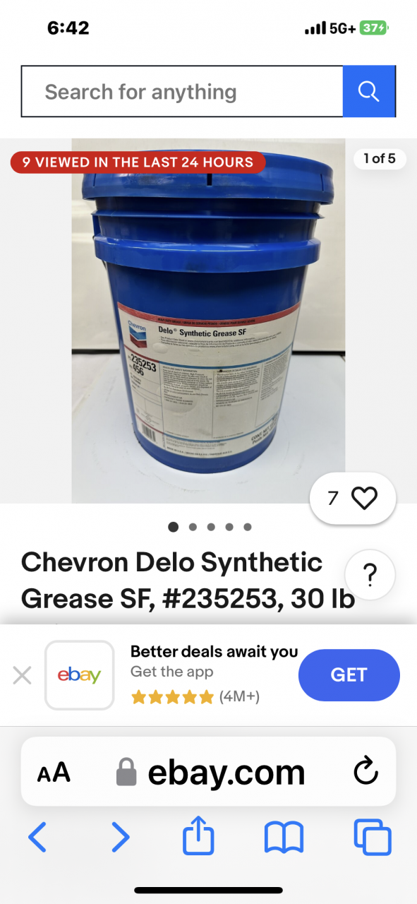

    Got the 3.5" socket today and so tempted to open a side up and see what it looks like. I think I'm still going to hold off and see what the temps say after this short run.
    Went to the Chevron website and the Chevron Delo #235253 doesn't even come up on their product list.

    A863A5F4-3CC7-4657-911E-5042C3912720.png Google is your friend. Readily available on eBay $175 a bucket.I’ve seen it in smaller sizes also.

    That was the next step when I had a spare minute. haha
    But thankfully they sell smaller quantities. That 5 gallon bucket would probably leave my grandchildren wondering what it's for. haha
    Agreed 100%. But I was looking at the Delo website and I was having a hard time finding anything that matches the description of what is actually needed.
    The truck sees maybe 10k miles a year. Yup, she's living the easy life now. But that doesn't mean I want to hurt her with sub-par parts or lubricants either.
    Great input guys! Google and Amazon is everyone's friend. Apparently Chevron discontinued this. Making the 5 gallon bucket look enticing. :)

    Shell makes an equivalent. A supplier in Louisiana had to look it up. They’d never heard of it. Lol. Anyway the type is in the article. I like Shell regular automotive grease. I’ve got some that’s 30+ yrs old. It’s very hard to wash off your hands. Leaves a film. Sold me. Good luck finding it.
