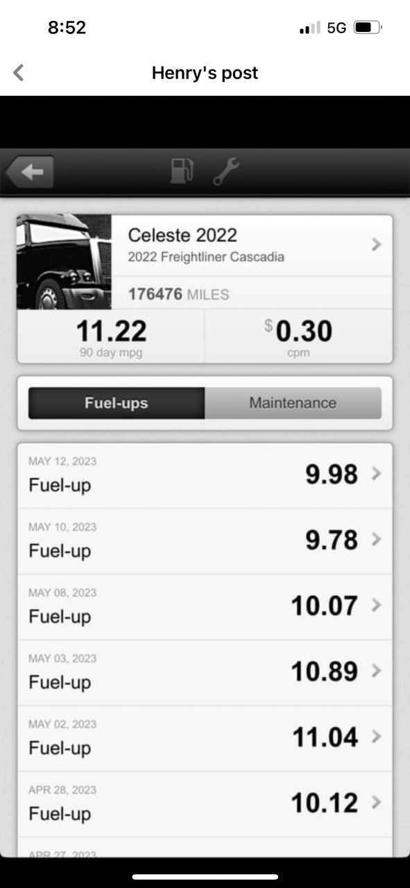

    Your better bet would be to find a nice Cascadia with a DD15 turbo compounding engine. The dealer support is incredible, the tractor is pretty slippery to the wind, and that engine fuel mileages really well.
    Henry Albert recently posted this for fuel mileage. Not only is he a great driver, he’s using the right tool for the job; a Cascadia.
