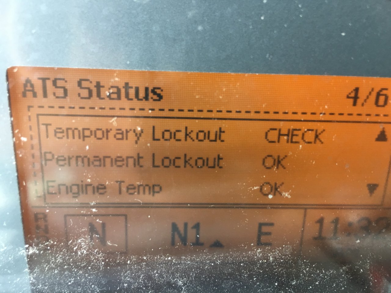

    HI, i have 2013 volvo and i have check engine light and this message, anyone know what this is all about, picture attached. Thx 6524.jpeg

    YOu are in the wrong menue
    SEt brake trany to n
    THen scroll dowen to diagnostic

    that means that your truck will not let you do regen cuz it has not asked for it and it doesn't need it you need to go to diagnostics in the sencond screen to view active faults engine ecu to be able to pull fault codes maybe vehicle message might give you something.

    Thx, we did find what the problem was. It turn out to be NOx sensor, disc. Batteries for a min all fixed, thx
