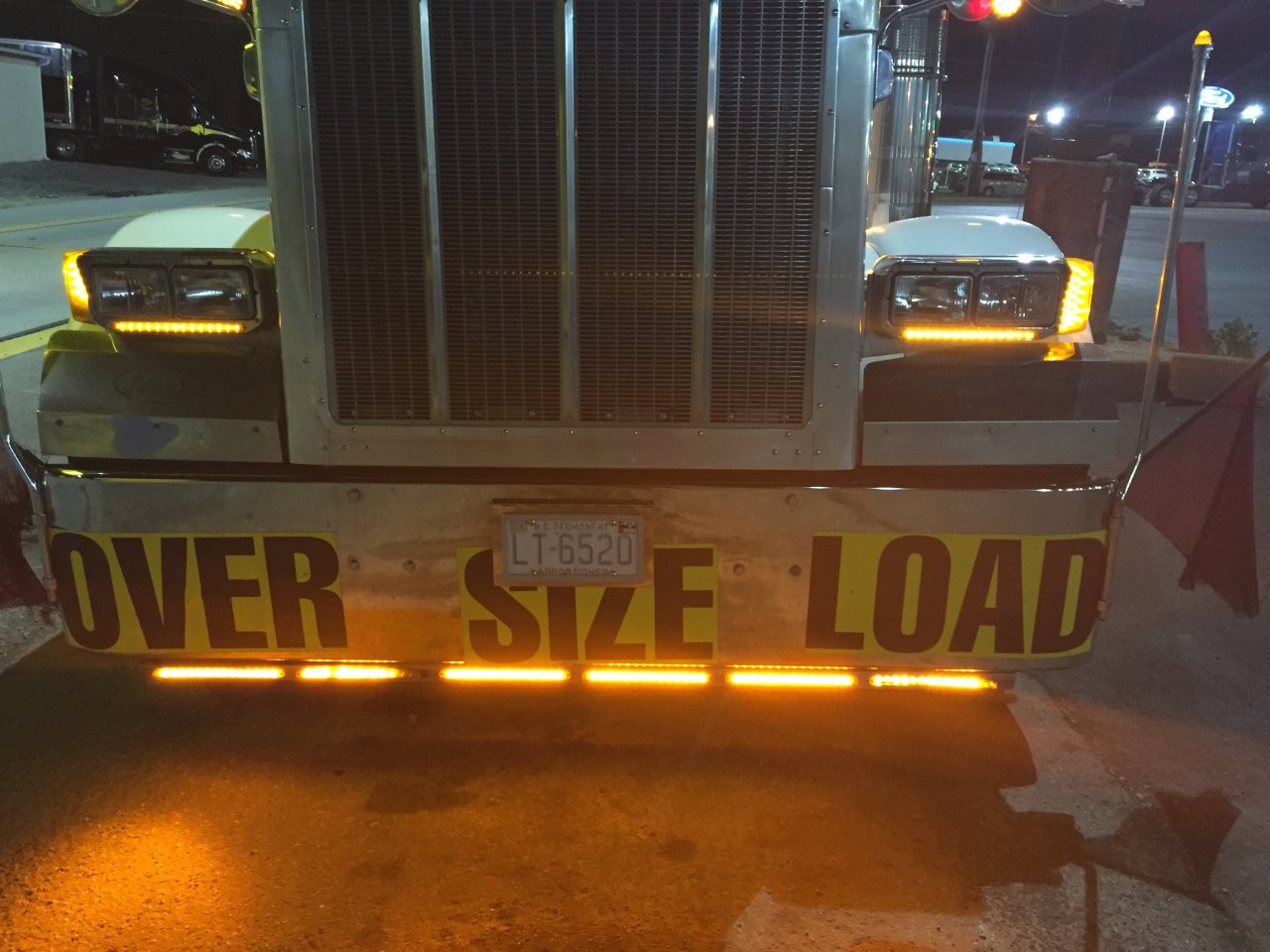

    Here is a pic of our signs they come in one piece ,we cut them in three section to miss the bolt heads on the bumper image.jpeg

    Does anyone know of any companies selling semi-permanent oversize signs that will mount to a Freightliner Casacadia ('09) bumper? Or have suggestions to make mounting easier? Just seems to be nigh impossible to get straps to stay in place reliably, and I hate buying new signs all the time.

    There are Signs made on sheet metal that hinge in the center. They have brackets that you can mount on the bumper and slide the sign in and out of.

    Do you have tow hook mounts on the front? Make you your own bracket to slide into tow hooks

    That's what I did on a T800H I owned for a short time. Just remember when you measure your overall length to include the sign hanging out in front in the length.

    Do you know any of the manufacturers selling those brackets? I can't seem to find anything that mounts to an existing Cascadia bumper without replacing the whole bumper.
    The truck does have tow hooks, the push and turn to lock ones from factory. I was hoping to find something that would use those mounts to secure the sign/bracket but maybe just need to build my own.

    The brackets I bought from a mobile home equipment store in Indiana.
    Try this place or similar.
    http://www.pilotcarproducts.com/pilotcarproductscgi/agoracart55/agora.cgi?product=Attachments&xm=on
    Oversize sign search.
    Good luck

    You will most likely have to make your own, I don't recall seeing any available that can buy
