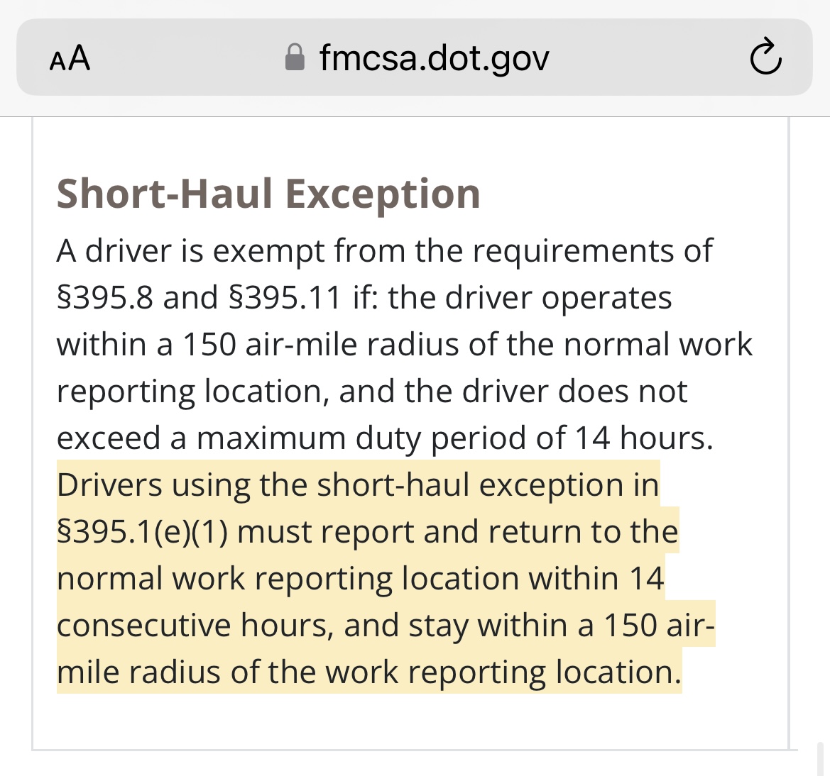

  11. Long FLD
    Long FLD Road Train Member
    13,033
    54,696
    Mar 4, 2015
    That’s no longer true. The 150 exemption now states that you only start and stop your days at the same location. Where you’re from no longer has any bearing on being able to use it or not. But he would still need time cards or something for his days worked, he can’t just toss everything out the window because he’s using the exemption.
