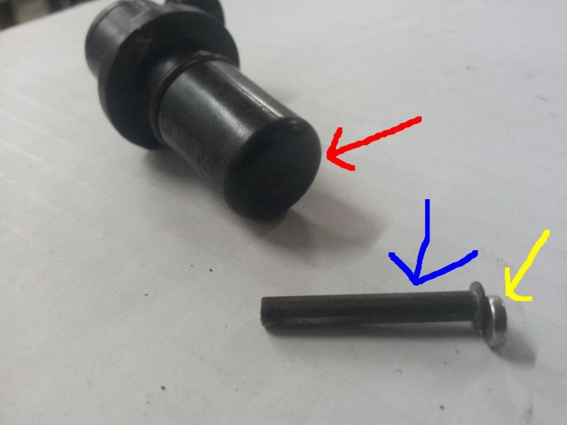

    I have come across this problem before and can point you in the right direction. The flashing "F" without the usual presence of a fault code is related to a current or previous speed sensor failure.
    What usually happens is the sensor will crack and eventually break, normally logging a fault code 58.
    The magnet in the sensor comes out and lodges between two raised sections of the tone wheel. A new sensor is fitted to rectify the fault and the magnet does not get removed off the tone wheel. This now affects the new sensors ability to give an accurate reading as it is affected by the magnet on the tone wheel.
    Attached images show what i am talking about. The magnet is pretty small, but it can pick up a 1" spanner.
    Another possibility could be a loose gearbox yoke nut. If the yoke nut is loose, this will allow the tone wheel to spin, as it will no longer be clamped between the output bearing and the yoke. A loose tone wheel will also give incorrect readings for the sensor.
    Get the guys to check for those and let me know what they find.
    Hope this helps.
