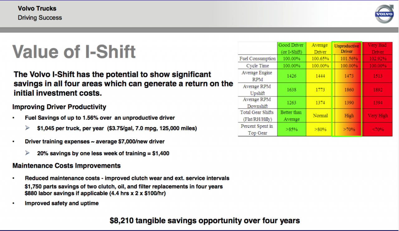

    The difference in fuel milage with a bad driver is marginal at best. You little calculus way over estimates the fuel savings. Even the folks that sell these transmission do not claim a 7% fuel savings like you calculate.
    The producer's of the most refined of these transmission, Volvo, proffer something like this: Screen Shot 2017-12-11 at 10.51.19 AM.png
    That is .65% fuel savings for the iShift over the average driver. I say even that is optimistic.
    Putting that in your 250 truck fleet with more reasonable milage, fuel cost, and fuel economy figures.
    [(250 trucks x 8000 miles/month )/ 6mpg x $2.50gallon ] x .65% = $5,416 saving a month for average driver with an automatic in a fleet of 250. Or $21.66 for a truck! And I say that is overly optimistic hyperbole used to sell transmission.
    You will never pay the premium for the automatic transmission, let alone it's repair, at that rate.

    The numbers don't lie. I've seen the actual historical fleet mpg numbers related to our fleet. Believe whatever you want.
    The biggest improvement comparison is the 2018's that went online starting this past June. It may also be attributable to the engine but the 18's will out pull anything in the fleet. And after moving into an 18, the drivers typically showed a .5 mpg improvement over the same quarter the year before. And it's a sizeable number of trucks to compare.
    About half retired '15 sticks and the other half moved from '16 autos.

    What I have seen in fleets I have run in is:
    Automatics get the the same or worse fuel milage when measured by the actual fuel they consume. Taken fuel milage from fill-ups, they are all the same milage.
    Taken from the Lie-O-Lot meter in the truck, many drivers seem to be convince the automatic does better. Same with ECM dumps. However, the most optimistic ECM dumps never line up with real world fuel economy.
    It is not the first time a company has skewed the data to sell a product. Just ask Volkswagen.
