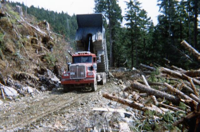

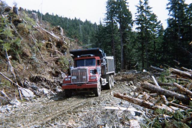

    This picture will show you why the extra reduction was needed. Trucks was never on public roads.
    This is on fairly flat ground, no rain so that in this picture surface was good. Grades reached as high as 15%. I never knew what the weight of a loaded truck was as it never went near a scale. One day they used this truck for bridge testing. As all the bridges were wooden structures, they did this by measuring the deflection in structure.
    The truck was loaded with crushed gravel, weighed, then placed in the middle of the bridge. I was shocked to learn loaded it was 112000 lbs, then realized why my tire bill was so high.
