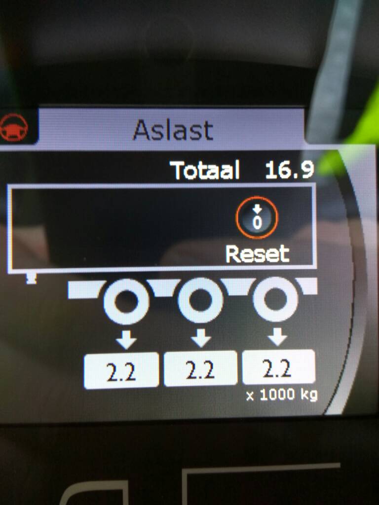

    Hello everybody and thanks for your answers. I am aware of the fact that there are many variables and these have been incorporated in the program as variables that can be changed. All I am asking is what the axle weights are of your empty semi-trailer or a specific empty semi-trailer that you are driving. For example I have received this from someone who has the system that I was talking about (language is in dutch; "aslast" = axle load):
    Thanks again for your help!

    2012 Kenworth T660 daycab super singles. Great Dane 53' dry van with duals.
    5150kg.
    6870kg.
    5090kg.

    One of our guys have a Volvo FH 2013 that shows 5.6 on the rear, 1.5 on the trailer.
    Another has a 2016 Mercedes Actros and it shows 5 on the rear, 1.5 on the trailer as well.
    Though the trailers on those are 12.5m long, so I'm not sure if it's any helpful.
