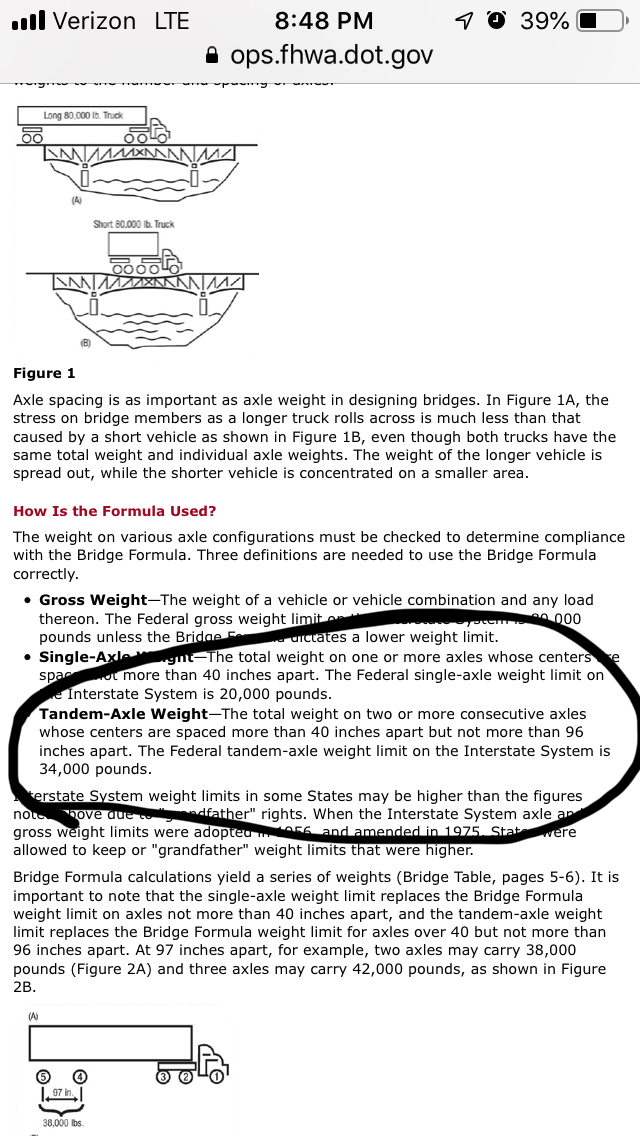

    Thats crazy is that just a state by state thing or is it fed regulation
  4. D.Tibbitt
    22,861
    158,091
    Wow that is crazy , especially since ive never heard it and ive definstly pulled hundred of loads that was more than 34k on 10ft spread. I guess it wouldnt matter tho as long as im within the 20k on each axles limit for 10ft spread, correct? Learn something everyday, thanks for the info my friend

  5. kylefitzy
    kylefitzy Road Train Member
    4,755
    19,812
    Aug 12, 2007
    Kansas city,Mo
    Yep keep it under 20k per axle and your golden. The tricky part is keeping the axle load balanced. I know the trailer I used to pull did not balance correctly over about 38k and I was over 20k in the front axle. The rear axle was sliding and had different size bags. If I owned the trailer I think a 1/8” or 1/4” plate above the bag as a shim would have fixed the problem.

  8. Pedigreed Bulldog
    7,737
    14,425
    May 7, 2011
    96" or less = 8' or less. Look at the chart I posted. >8' to 9' allows you 38K. >9' to 10' allows you 39K. >10' allows you to run 40K. That's why it's generally a 10'2" spread, to get the full "2 single axle" weight of 40K. If you're just barely 10' (and not a hair over) on the spread, a "by the book" cop could enforce the 39K on you.
  9. x1Heavy
    x1Heavy Road Train Member
    34,016
    42,144
    Mar 5, 2016
    White County, Arkansas
    So a 10'1" I had up north on a 48 foot with 40K on the back perfect 20 and 20 on the dot to the pound, throw a bible on there and it's overweight. And they will refuse to accept that?
